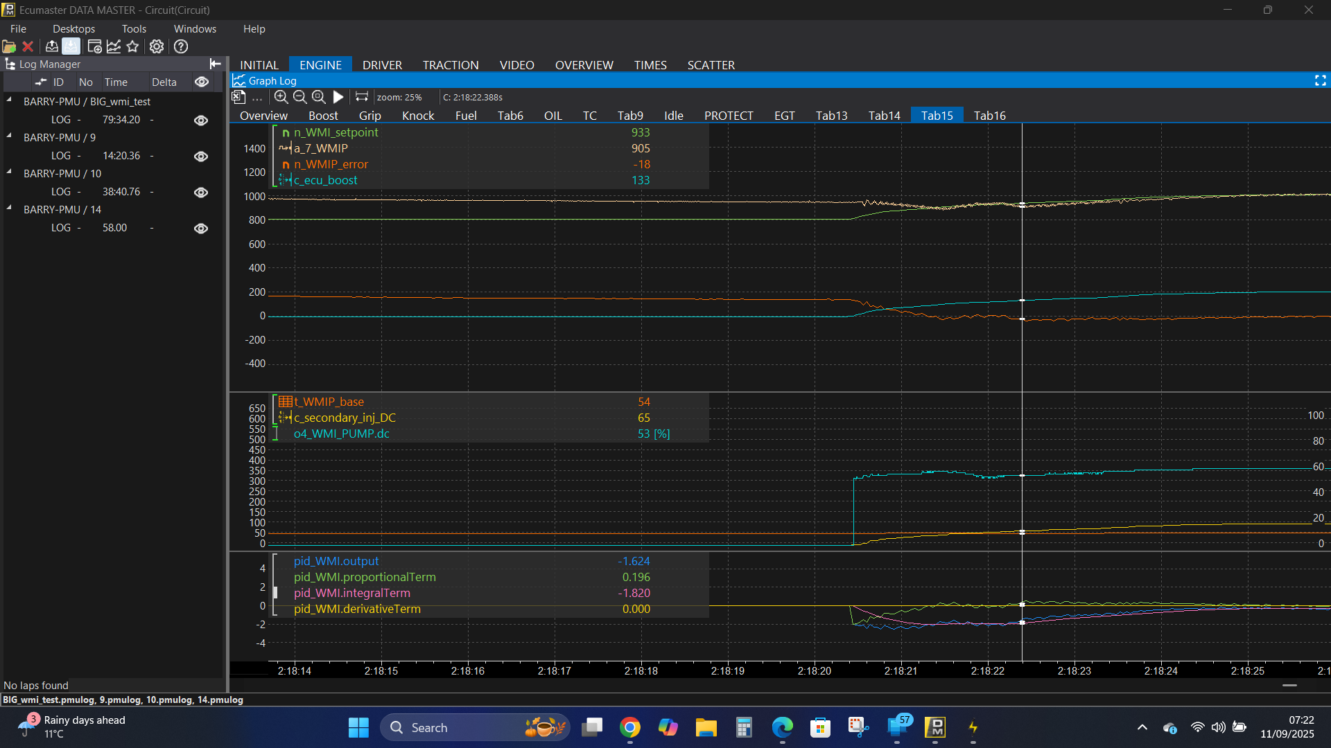

I’m struggling with a noisy fuel rail signal causing issues with a PID I’ve setup to control the pump, filtering would help greatly.

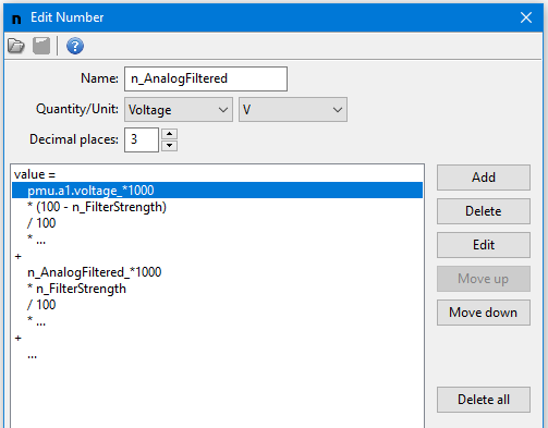

We will add a native way to filter the signals in future updates.
For now, you can make a simple IIR filter in the project tree.
Filter strength is from 0 to 100.
