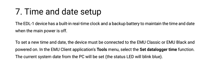

You need to set the date and time from the client software settings when connected to the car. I can’t remember the exact menu selection but it’s something like “set datalogger time”. Found this in the EDL instructions.

Try to setup your EDL real time clock from EMU (Menu Tools / Set datalogger time)
That’s it. Thanks.
I set up the timestamp when originally installing the EDL-1. It did not occur to me that updating the firmware would require resetting it. Maybe a note in the manual that it is necessary? Even better, check and auto update the timestamp whenever a PC client is connected.
