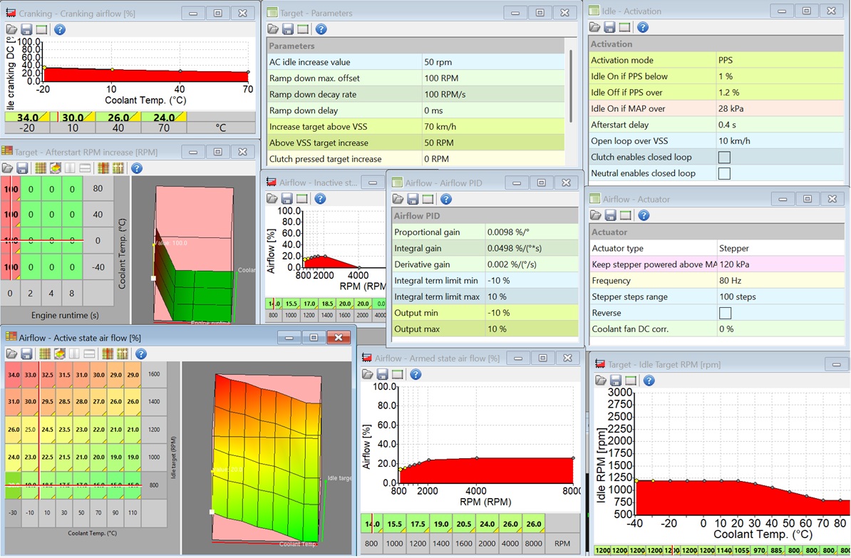

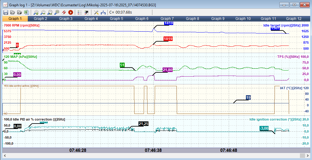

Gents Iâm experiencing this behaviour that on COLD engine, so basically first 3-5 minutes I need additional AIR for the engine.
While IDLE works perfectly fine, I either miss something, or there is no (?) IAV control related to warming up that would work independent from IDLE strategy?
Basically when engine is cold and I barely touch acceleration pedal, idle control active goes to NO (correct behaviour), but also IDLE PID air % correction goes to zero (correct, as idle is inactive).
This unfortunately creates a situation that engine almost dies due to lack of air on cold engine and low RPM.
See attached screenshot.
In the warm up there is only fuel enrichment / lambda.
Idle has all I need, but goes inactive when gas pedal is pressed ![]()
What I am missing? What Iâm doing wrong?
I expect that a table with IAV % adder related to CLT is what I need, but itâs not there?
Or Iâm just blind? ![]()

You have +21% correction ! Adjust âActive state air flowâ table (bottom left) to have a lower correction.

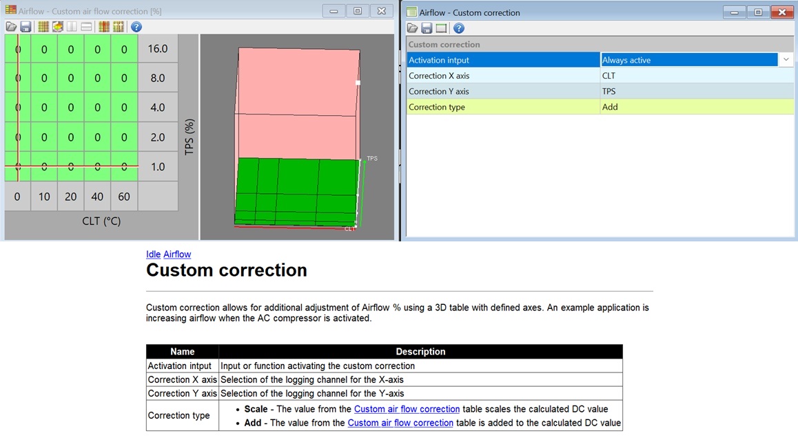

When Active (IDLE) it works good. The problem I have is when IDLE is inactive and the engine is cold. I miss a table like in V2 where I could set IAV opening % based on CLT (that would work when IDLE is NOT active).
For reference discussed a bit here as well:
Just nailed down now to the moment when Idle is not Active.
So I now have much better drop to idle control but a few times it has still randomly stalled. Please see attached log log
20250720_1358_10.emub3 (67.4 KB)
the stall happens at 3:10 driving in traffic.
