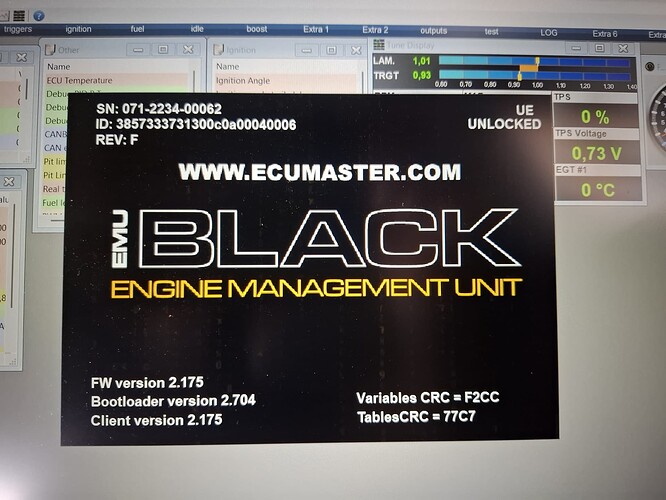

![IMG_0214|690x365]
(upload://uyhCxbNg4MKvOvMSunpfhbzpLUw.jpeg)

So this one need pullup or not?
It is O revision, the resistor is not required
So I bought the new USB-C Black, but this is still revision F, do I still need the pullup on a ‘new’ ecu?
The USB-C version doesnt require resistor for LSU 4.9

my revision is also F but i see that it can be wrong in the post above?
I have an ECU (EMU Black) the SW shows REV F, CPU REV G. I don’t know why it has two revs, but as I understand for my ECU the resistor is reqiured.

REV F is the revision of the main board. Rev G is a revision of microcontroler (the CPU).
