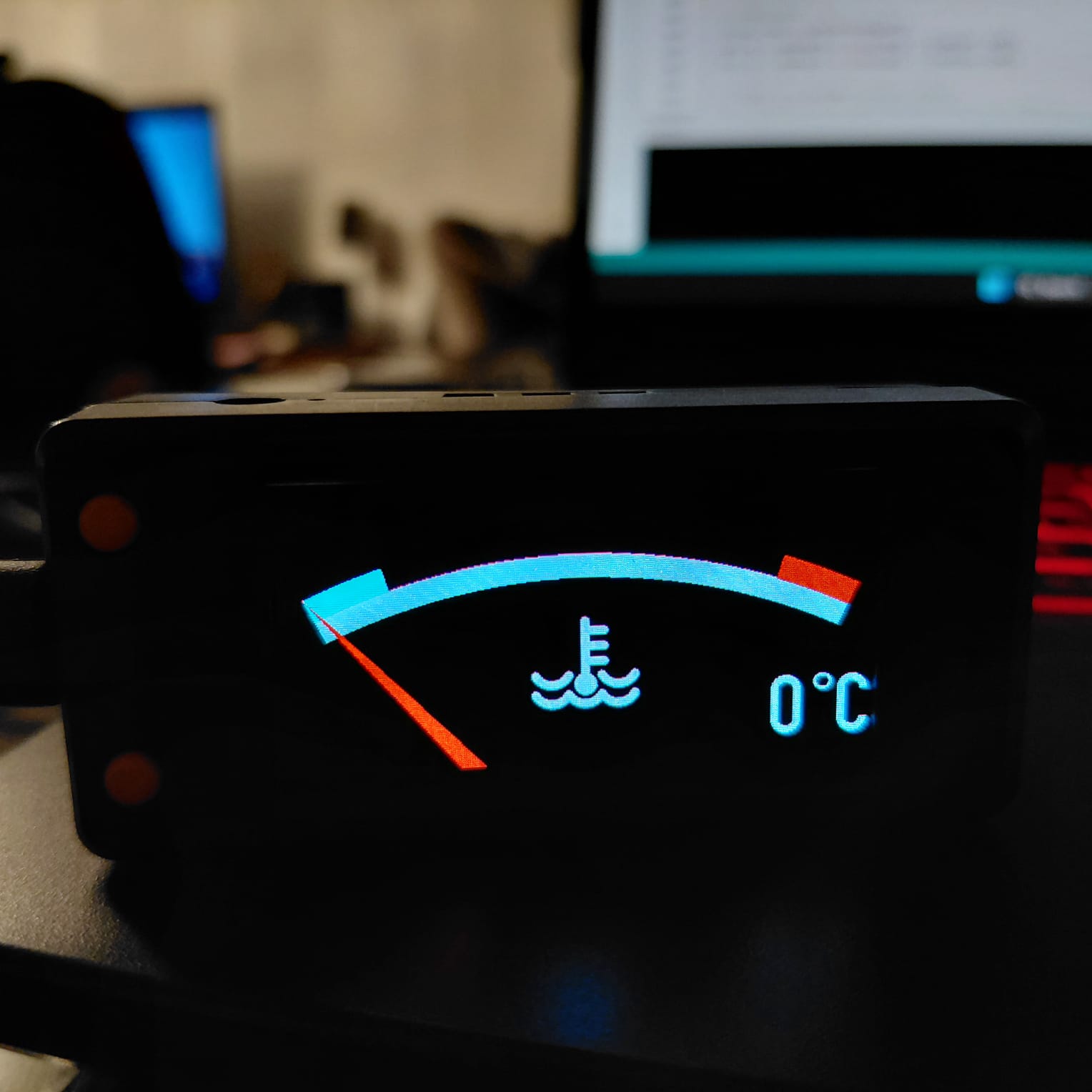

For the display, I’m using a LilyGO ESP32-S3 AMOLED (1,9", 536x240). Here are a few prototype screenshots. Once I get it mounted in the car, I’ll share more details and the code.

This is the code. But I junt want to remind you i am not programer or coder.
This is the screen I used T-Display S3 AMOLED – LILYGO®
You also need RS232 to TTL Converter board so get serial data from Ecumaster
