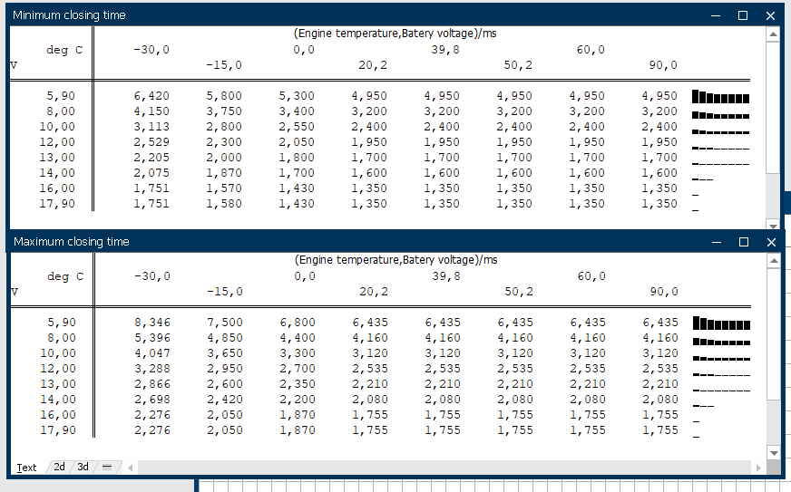

I have these coils 0 986 221 023 (VAG Short) and I’m looking for the dwell times. does anyone have these? Haven’t found them anywhere on the internet… How similar are the vag coils, can I use data from another similar coil?
Thanks for the reply. So this is taken from an engine that is using these coils from factory? ![]()
yes correct from a stock ecu
