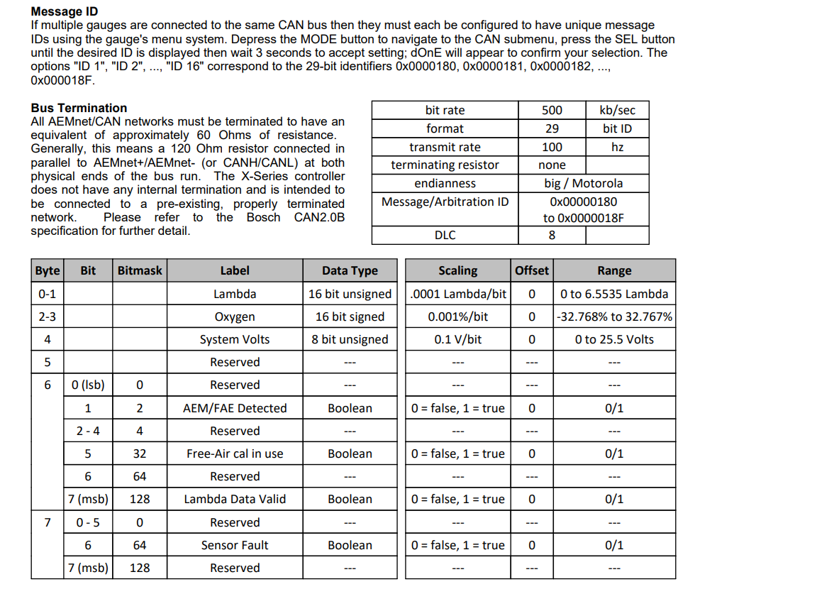

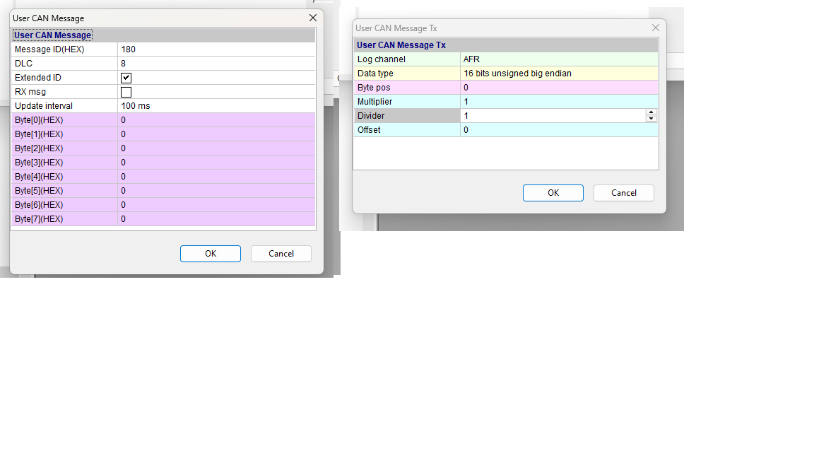

Hi everyone, trying to add my AEM wideband to the ECUMaster CAN network which already has a CAN gauge added to it. I tried the following settings but the program won’t accept a divider smaller than 255, and I need 1000 for it to properly display AFR.

According your settings you are transmitting message not recieving..

In EmuBlack, the lambda channel is 1 bit = 0.001 lambda, so you can set it by dividing the received value by 10.

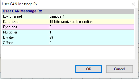

However, when I tried it, simply dividing by 10 caused the data from X-UEGO and the display to be quite different. (The data from EmuBlack and AEM are displayed on RealDash.)
I don’t know why this is, so for now I multiply the data by 4 and divide by 39, which gives me very close numbers.

Thank you, I’ll try 4 / 39!

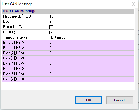

On my vehicle, the CAN ID is set to 181 instead of the default 180 because if it is not 181 it will conflict with other IDs.
