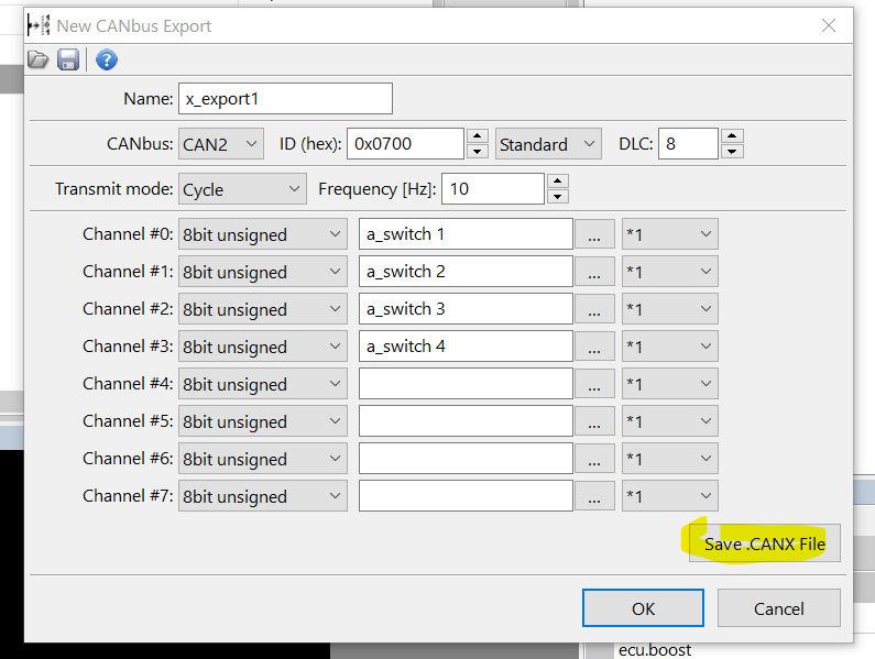

I have 4 switches connected to digital inputs on an ADU. I have exported these over Can and would like to read them on the EMU black to control tables, boost, launch etc.
I can see the change on light client but how do I set it up in the Black as cannot seem to get it to read.

You’ll need to create a custom CAN stream in the black to receive the data sent from the ADU
I’m assuming the Black and ADU are already communicating ecu data so the CAN bus works. You’ll need to assign the CAN Bush dashboard in Black’s CAN parameters to “user defined” to enable it
