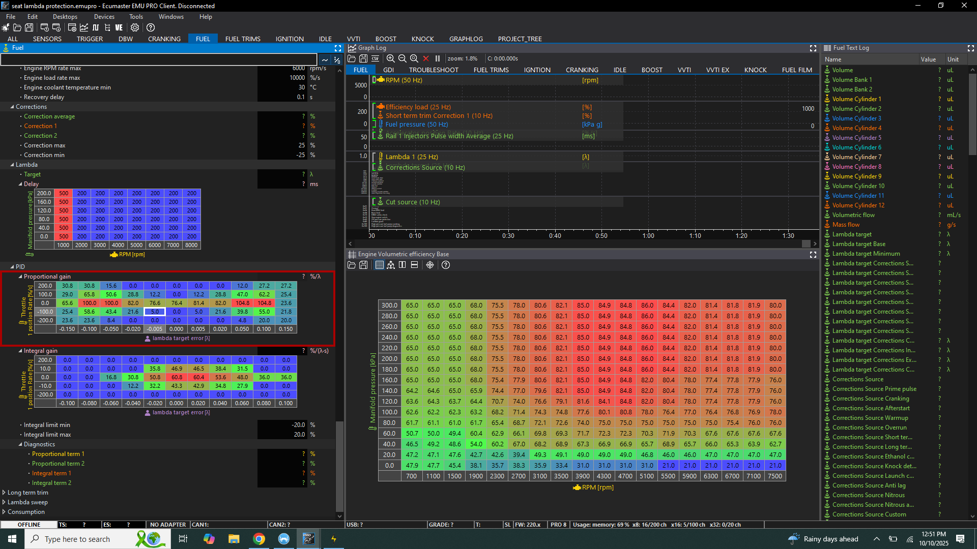

hi, would it be possible to think of some way to import tables and tables with values from some other file? and after that something like parts of config excluding input/output values? like here I have table with closed loop stuff I want to have in another config and now I need to manually create axis, copy data and so on and so on.. which takes annoying amount of time..
If you want to copy a whole table without modification, you can save it to a file.
Right-click the table to save or open it from a file.

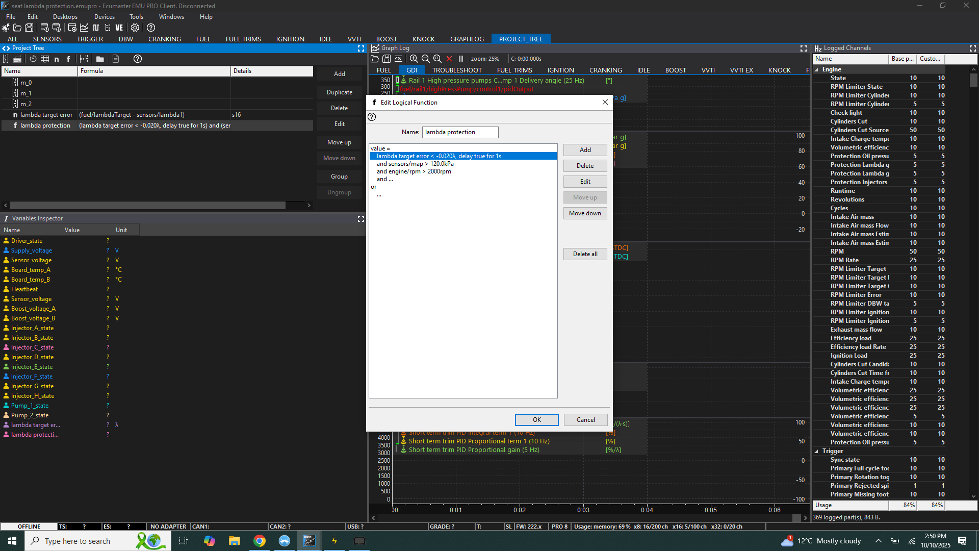

and another thing, maybe I don’t see, is there a way to copy function from project tree?
No, and that is the main reason we need the project export/import feature.
