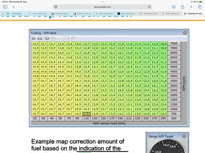

Running the system on 2.175 with fresh FW. The AFR table resolution in rows and columns is half the size compared to the VE table. Cannot find yet a way to sync both to same set up.

The table sizes are fixed so it is simply not possible. But the better question is why do u want to sync them? There is no benefit in haveing afr taget table the same high resolution as VE. U dont need that much resolution in afr table.
….well, the manual is showing the tables same resolution, and if I recall well, somewhere it was shown, that you could edit and add per your desire. That’s why I was asking.
If there is no way to enlarge, I need to adapt accordingly.
Many thanks to your early reply this morning!

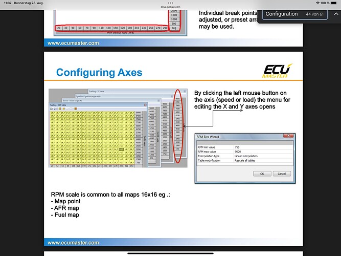

..this is what I meant. The manual shows a much bigger table…mine is limited down to 10 rows only…
I think here the screenshot from the manual is wrong or very old. In Black u just can’t chnage the size of the tables. But as i already said…it is quite useless to have such a detailed AFR table.

I am just a normal guy, but i know the SW and in EMU black the amount of points on the axis is fixed. In emu pro it is configuratable.
The manual here is definitly false. Reason: I dont know :smiley:
Maybe someone of ECUmaster team reads this and updates the manual.
Where does this document come from? I think it is not published on our website, so we are not maintaining or updating it, and we cannot take responsibility for it. The screenshot you posted comes from an older version of the software. The table was later reduced in size due to memory limitations, which allowed us to implement more important features elsewhere.

In the previous firmware version the Afr table was much bigger as in manual.
However such big size is usless for AFR, the size of rhe table was reduced to save memory for other strategies.
