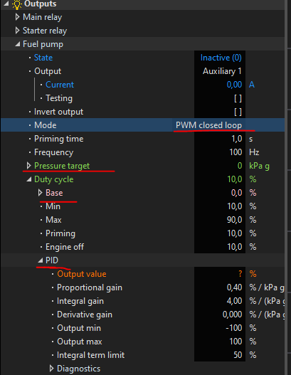

Can the EMU Pro (along with a PMU AS) provide precise control of a fuel pump? I want to keep the low pressure (located in the tank) fuel pump providing fuel at 5 bar using PWM outputs. In a MoTeC M1 I’d use PID controls for that. Does the EMU Pro support such a feature?
Yes, there is a closed-loop fuel pressure control strategy.
Closed loop works great here.

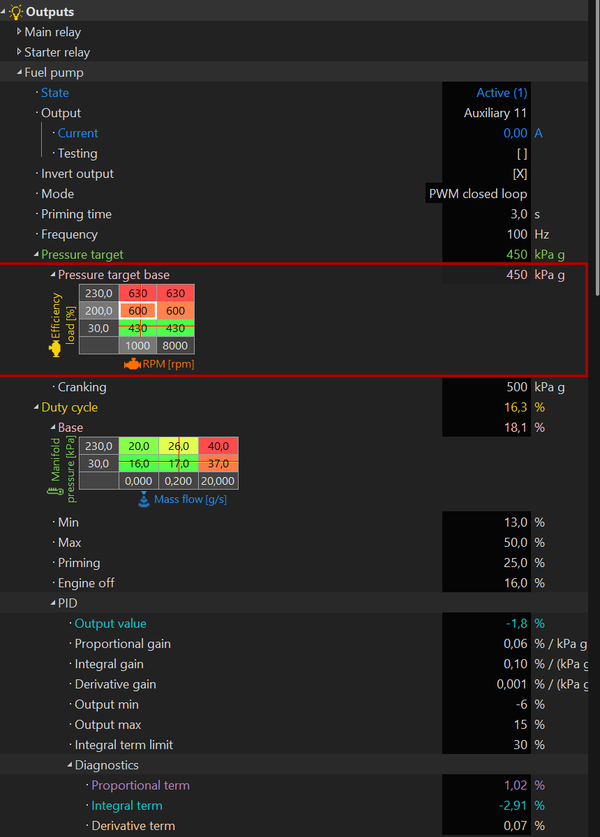

Running full VAG brushless LPFP system on two cars at the moment
With virtual manifold reference and up to 6,6 bar (VAG relief valve)
