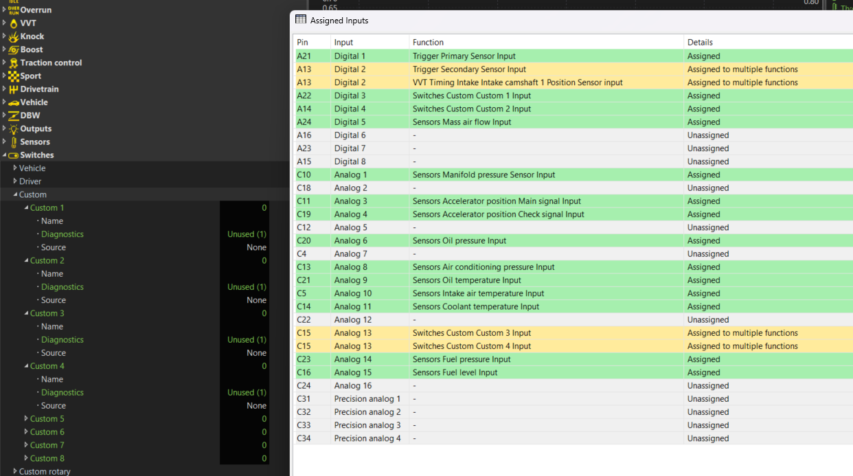

Known problem? Assigned inputs window doesn't match
I’m working through my inputs now, and it seems as if the Pro software is confused. Or maybe it’s me? Notice how I don’t have any custom switches. They are all blank. But the assigned inputs window thinks I have 4 of them at Digital 3 and 4 along with Analog 13. Is there a way to reset this? Or am I doing something wrong. I’m on Beta 222.
Emu pro software remembers pin assignments (and CAN message assignments) even if you disable the source
You need to unassign them before disabling
e.g.
Custom 3 → source change to input
Input change to none (currently analog13)
and then source change to none
Excellent, thanks! That cleared it right up. I’m still getting a warning at Digital 2, but that’s because the VVT is using the CAM sensor. That’s expected, right?
Yes that is normal.
The input is used for triggering and for the VVT position
Cool, thanks very much.
