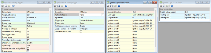

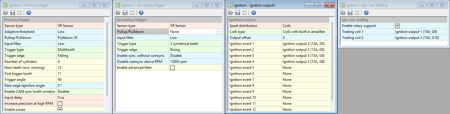

I would really like to use my 13B rotary with the V3 software, but there isn’t the exact same trigger settings available in V3 yet. At the moment I use the factory trigger from the RX7 FD. Two VR sensors: primary = 12 toothed wheel for engine speed (multitooth) and secondary = one additional tooth for engine position. All is on the same trigger wheel. In V2 I used multitooth for primary which worked great and is available in V3. For the secondary trigger I don’t have the option to use “2 symmetrical teeth” which I need because of the fact that the rotary fires in every crank rotation like a two stroke. I don’t have this option in V3 until now. Can someone help me figure out how I implement my V2 settings for my 13B in V3. Or is an update with the “2 symmetrical teeth” option the only way to do it?
The screenshot is my V2 trigger settings.
Rotary engine support is not avaialbe in V3 softare. For rotaries you need EMU PRO where the rotary support is perfect.
What do you mean with there is no support? You mean the Oil Metering Pump option from V2? If you mean that, I don’t need this option because my 13B has no OMP (using two stroke oil in the tank). From what I see there is a second stage for injectors and also trailing spark support, so I don’t see a problem using V3 with my 13B. I only need this specific trigger option I’ve shown in my screenshot. I use my RX7 for over a year with my EMU Black with V2 until now.
I’m pretty sure if you add the “two symmetrical teeth” option for secondary triggers I can run my 13B with the EMU Black and V3 or a different setting which mimics the “two symmetrical teeth” option for my secondary trigger.
edit: I forgot about the trailing coil option from V2, you’re right.. I would need that as well, so this does not come to V3 at all?
Unfortunatelly it is not planed due to limited harwdare resources left.
Oh no, really? There is no way to convert it from the V2? I would love it if you could make it happen..
