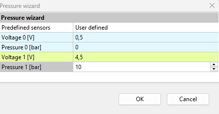

I am currently adding some more sensors, but the Bosch temperature/pressure sensor (PST-F 1) is missing from the sensor wizard, could this sensor be added please?

Try below settings.

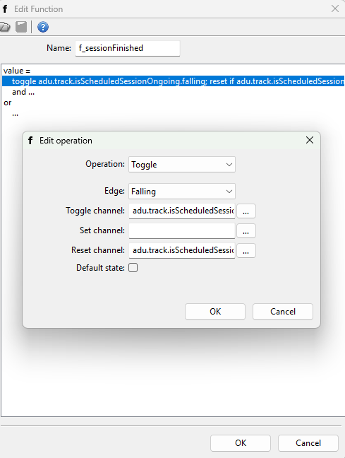

After the session I need the falling edge.
Functions can’t check for falling edge as far as I know, i can only use the value of the flag in a function, and obviously adu.track.isScheduledSessionOngoing=0 does not mean session is finished.
other timers have .elapsed values, which are great for this!

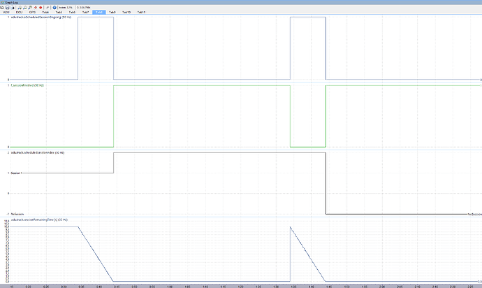

You can achieve it using function:
which gives you result as below:
However - we can add ‘session elapsed’ channel or something like this in next release.

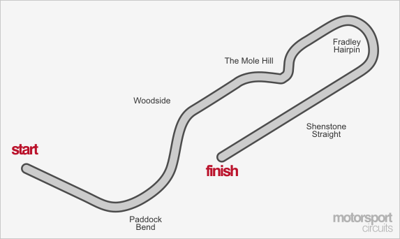

Heading to a track tomorrow that has the start/finish in slightly different places, am I best to use the ‘hill climb’ lap timer? Will this still sync ok in data master?
Are you driving on a closed track with start/finish in separate points?
Yes, it’s actually a very popular sprint track here in the uk. Possible future track to have in the ADU? :slightly_smiling_face:
Okay, then use the hill climb mode. We have tested it with Data Master and had no issues, but if you find something unordinary let us know.
edit: please remember to use “Rally” project type, as it is the one supporting separate start/finish
Regarding the ADU, @mfudala_ECUMASTER I don’t know if our current setup for build-in tracks can support separate start/finish points?
No, built-in tracks support only circuits where the start and finish lines share the same coordinates.
There is a rough plan to allow creating user tracks for hill climb mode in the future.
Until then, hill climb mode works only with button-defined tracks.
