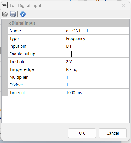

I did this an a1992 VW Corrado.
I tapped in a single wire from each ABS reluctor sensor at the ABS ecu.
I used multipliers/dividers when receiving them on Black to convert the signal to km/h
