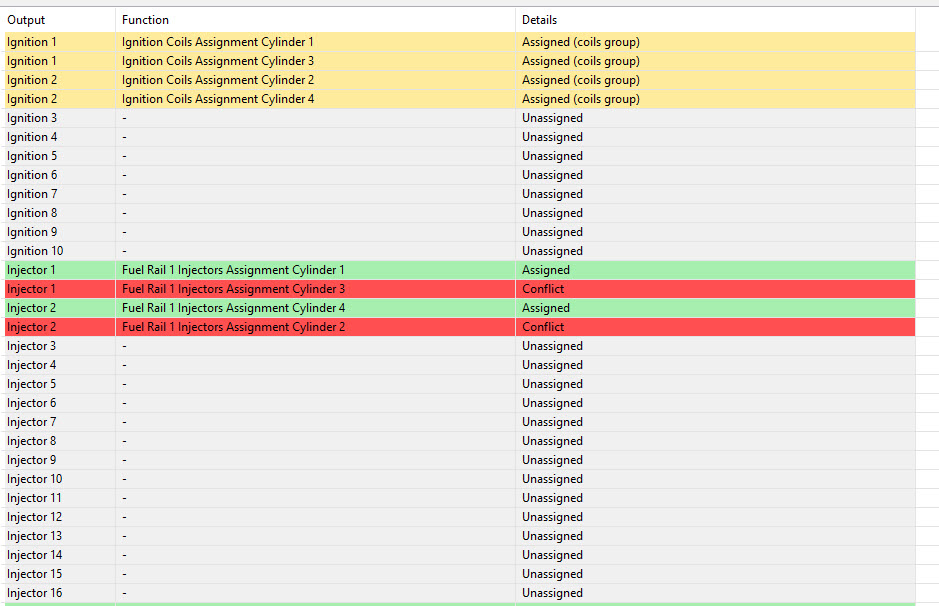

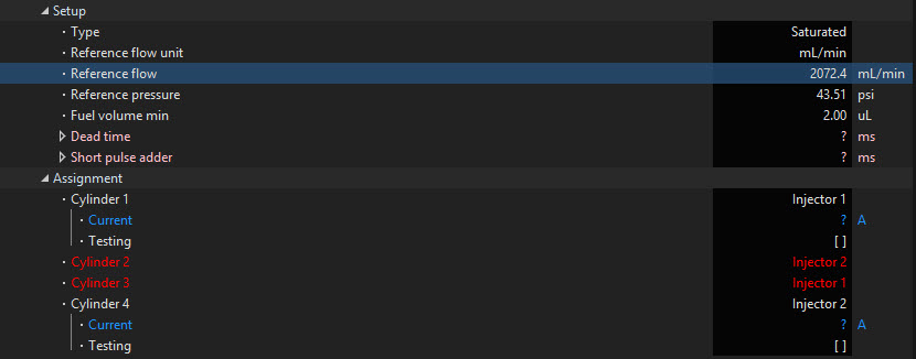

Thanks for the quick response! Based on that, is this what I should expect to see? It looks like it doesn’t love me selecting the same output for different cylinders. Does it just turn red to bring it to my attention, or will it not allow it to work while configured as such. When I look at the assignments page, it says there is a conflict. Ignition outputs are configure just like the injectors, but they happily group up, and recognize the intention.
Did I do something wrong with my configuring there?
Yeah that’s to draw your attention to it as a possible issue. As Mkuklis said the batch injector’s need a feature added, but wastespark is covered in the current software.
Black/Classic do the same but the output will operate if either assigned function tells it to.
As long as it will run while having an internal conflict I’m fine with it. I just don’t want to hook this sucker up and have a car that needs to be completely rewired in order to run.
