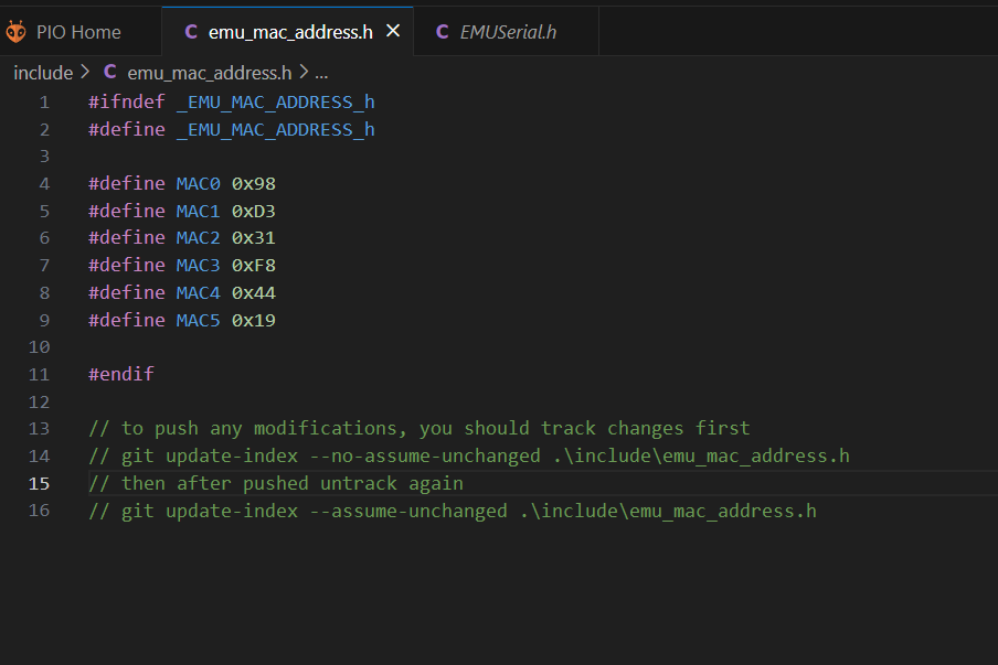

Today i could get the Mac Adress from my EDL Logger.
The only App worked for me was “Hidden Bluetooth Scanner” V6.0 it took some minutes and the EDL Logger showed up. So i typed the Mac adress in the emu_mac_adress.h and it look like it is connected to the Display! Im excited to test it when im back at my car, maybe this weekend.
I need to upgrade my skills in reading and understandig the code. I want to “inj” to EGT1.
But thats only a nice to have. Im happy to see progress in that beautifull display. Thanks for the developer and @eudes

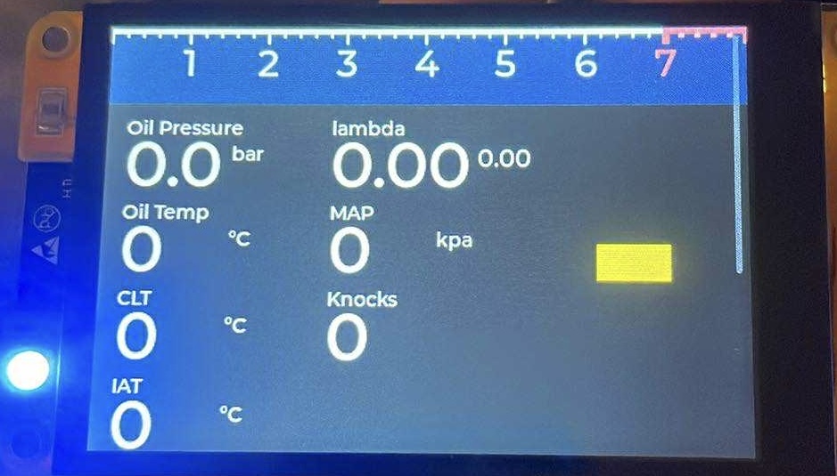

Hello. I am new to programming and with your info I managed to make my esp32 3.5inch monitor work and it is very very good !!! Thank all of you reading the conv I managed to do that.
Can I ask Eudes if is it possible to add some more info on the screen like fuel press, tps position and also what is the yellow block in my screen ?
I will be happy also if I can contribute in any way ! Thanks !

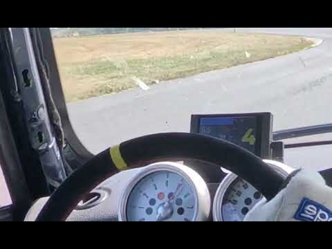

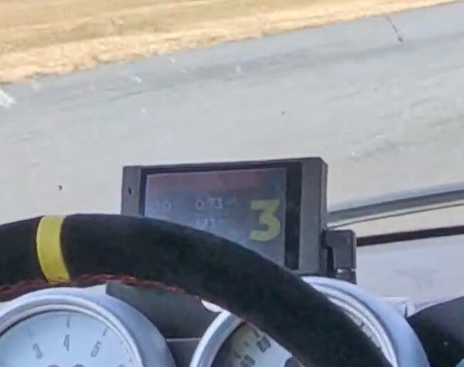

The yellow dash will be replaced by the gear .
I uploaded a video , so you can see the behavior . Will try later to create one better
Ok now I understand what is that yellow parts. Is that easy for you to add some extra info on the screen like I said you before such as tps and fuel pressure ? Or tell me the way I have to do and I will try ? Thanks a lot !
Since I refactored the UI, it’s really easy to adapt the display.
I will try to update the git by the end of the week with some documentation to help for that changes.
You should replace instead of add, as it’s pretty unreadable if it’s too small (the reason I moved from 2.8" to 3.5")
The 2.8" is working but there is a pb of mirroring, so open to see a PR with the fix, It might be a lvgl config or TFT setting.
Personally, I ordered a 7" screen, so will create a new repo.
I will try on the road to see how much info is readable on that 3.5 screen. Thanks a lot I will be waiting for your extra info to customise mine with my readings ! Have good day !

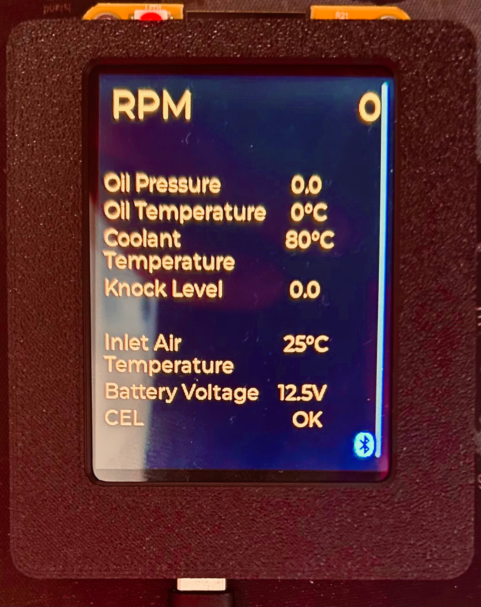

I just wanted to reiterate my thanks for kicking this little project off!!! I am NEARLY where I want to be, creating a custom OBC for my E30. I want it to look retro, but having issues trying to create custom retro font. But just using the standard LVGL font… I am still pretty happy. Making it dark orange to match the cars existing instruments looks good. I am going to shorten the names a bit and bump the font up in size, but once there, i’ll be happy. Had a ball learning all this stuff too (both 3d printing, for the mount, and coding). That said it has taken me WEEKS to get to this :sweat_smile: !!!
