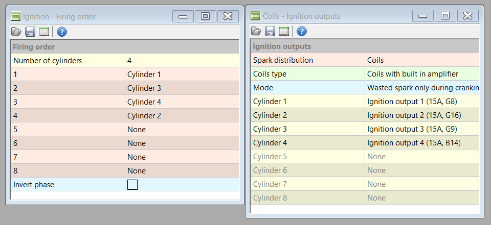

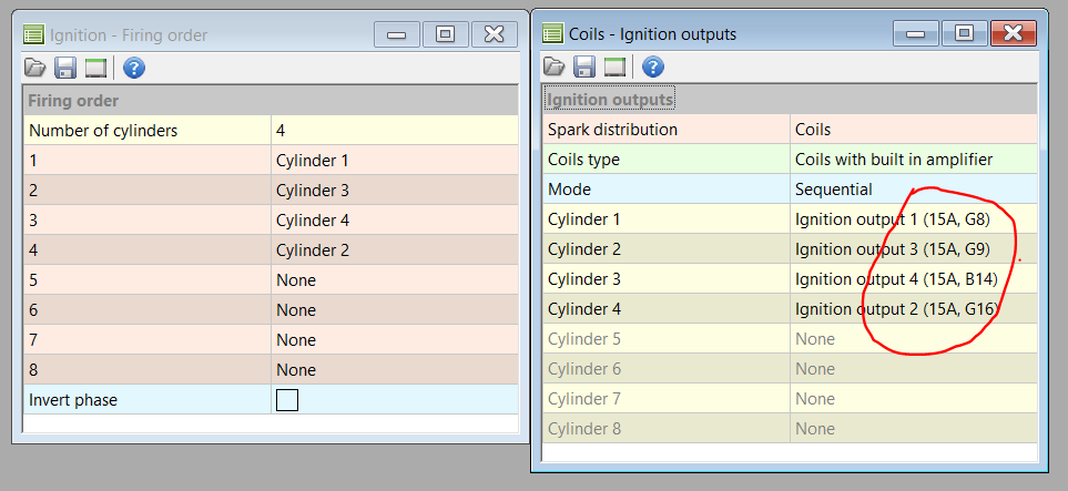

Hi, could your ignition outputs be assigned wrong?
Mine from porsche 931 look like this:

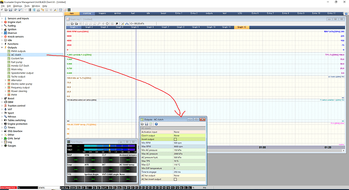

Hi, I’ve noticed that when I’m on the log screen and go to click on boost duty cycle feedback table it won’t show when double clicking on it. Everything else seems to pop up as expected.
Update*
It appears I have to minimise the log window and close the duty cycle map then enlarge the log window to then open the duty cycle map again.

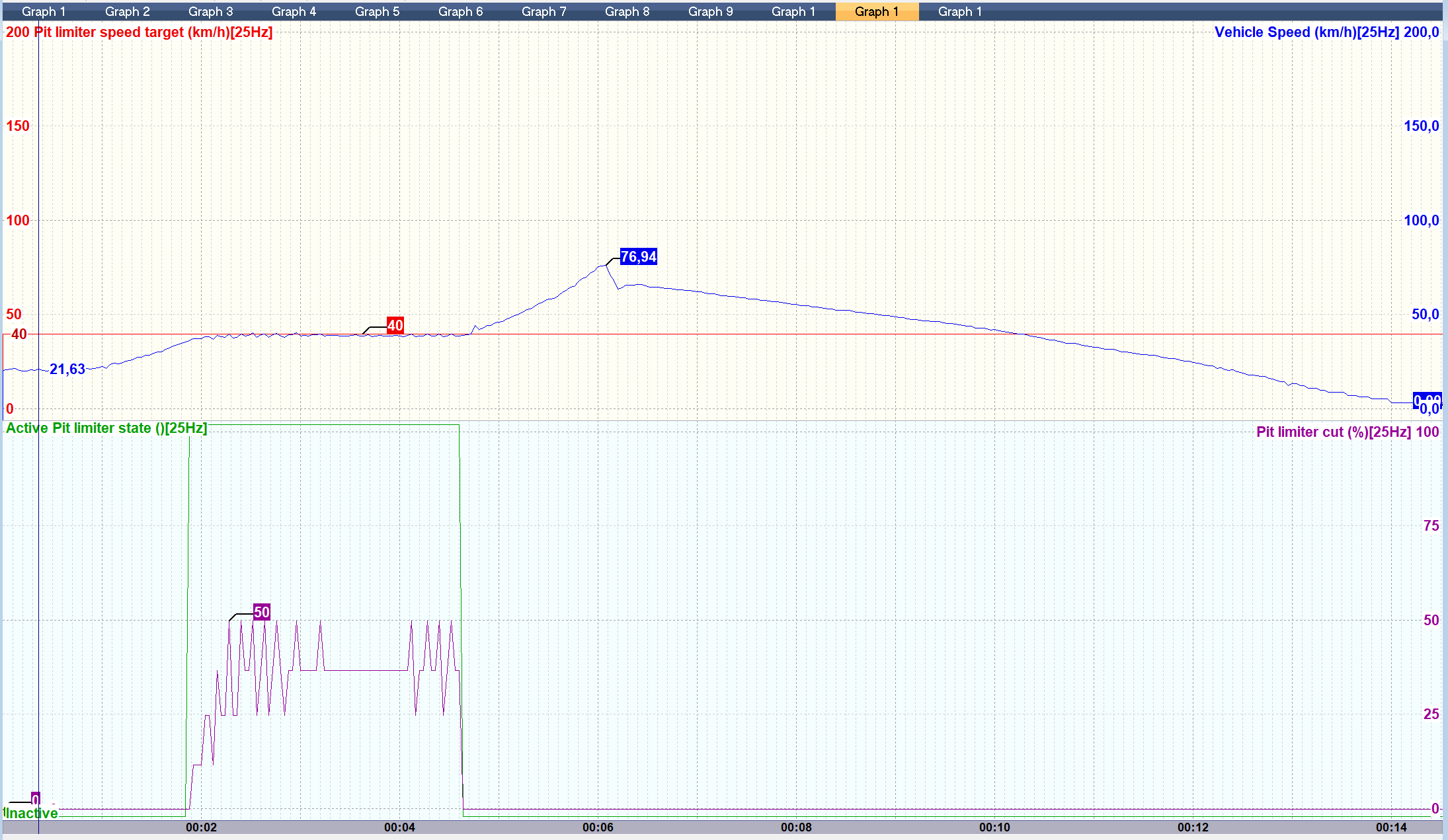

Hi.
My Mapping for my Seven w. Yamaha R1 is going very well, and most is running..
BUT I have a AIM Dash, most data is OK from Black → Dash.. but not PitLimiter Activated..
I have it running and working but can see when active in dash..

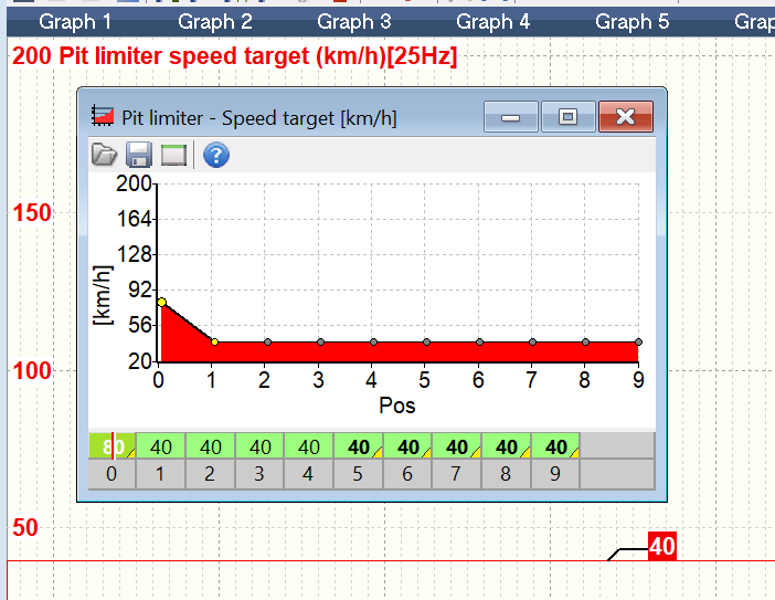

I also noticed that I had to restart ECU for new pitlimit speeds to be read(I have fixed speed using col 0) :wink:
/M
p.s. I have a AirShifter mounted, and all controlled from ECU (actuators and paddles) with some nested functions I have added a 100ms delay that is needed before activating the Cut/Blip.. it works.. LOVE functions… :wink:

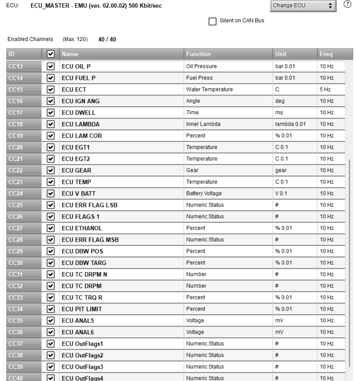

It shouldnt. Could you provide me you base map ?
Do you use EMU CAN protocol in aim ?

Its set to Serial

Yes, and all other parameters seems to work..
But I do see periodic ticks on the PIT limiter… but this comming both with limiter activted and deactivated.. pitlimiter works fine :wink:
and no change to speedlimit is activated live
