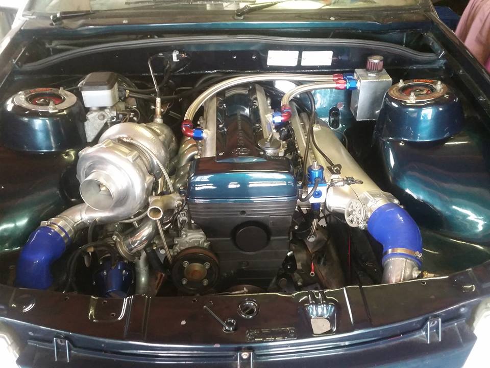

Hello ! ECUMASTER like most other ecu’s calculates injection time including Intake Air Temperature. The problem is it alters fuel injection time invisibly because of the ideal gas law (like every other ECU) because of the Intake temperature, which is different than the extra IAT enrichment ECUMASTER has (again like most other ECU).
What i would like to have is
  • An option altering or disabling the IAT from the internal calculation because even when every IAT correction Table is ZERO, intake air temp alters my injection pulse. This is most obesrvable on idle and in Traffic that creates a situation where the heat soaked manifold shows e.x. 55-60celsius. The AFR goes lean, when you roll and temps cool down, drop it to idle again, now AFR is good again, and that makes people go crazy by the incosistent AFR. Megasquirt has a different table for that and they call it MAT AIR DENSITY TABLE
HKS on older aftermarket ECU’s had an IAT 3D correction MAP. Like the charge Temp ECUMASTER has, but HKS had Axis of IAT vs LOAD. so you could make your IAT correction more neutral in IDLE and more enrichment on high load situations where you know IAT can and would be more Substantially affect your final AFR

The real solution to this problem is mechanical. Move the intake air temperature sensor. It’s much better to put it further away from the engine head and limit the possibility of heat soak than try to compensate for it in the tune. Think about the fact that OEM never puts an IAT sensor in the intake manifold if it’s made from metal. You can often find IAT sensors before the throttle, for example. It’s also easier to compensate for the sensor being further away with the charge temperature correction.
Check also my answer below the picture, HKS ecu had a 3D map IAT vs LOAD, also Megasquirt tries to tackle the problem by letting you decide what do you want it to do with the fuel calculation and AIR Temperature…
Currently as is with no options i can only rely on Short term Fuel Trim from a wideband… Moving the Sensor around on a turbo system is not easy, especially when there is so many OEM setups. Nobody is going to start drilling holes and guessing a good placement ( was tuning a Ford Fiesta Mk5 Turbo this weekend and the engine bay was cooking everywhere).

There is no need to guess. Do you have a picture of the actual setup? From my experience, the heat soak is only an actual problem if you have the sensor mounted in a metal intake without heat isolation between the manifold and the head. Just move the sensor away to the first plastic/rubber/silicone part of the intake. Hot air in the engine bay is not an issue. The problem comes from direct heat conduction between the engine and the sensor body.

example e30 M42B18. Runs great even without having a maybe future 3D IAT table, this one needed quite the IAT correction, but he has a phone app so i couldnt screw around with his IAT value…
Sensor is plastic, element hanging mid-air. Before throttle body as per your commands. Metal pipes because…Boost.
