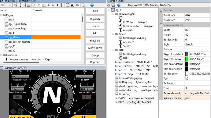

Hi, I’m trying to find the correct can message for both LC and ALS state, I’m trying to use a simple indicator message on my ADU (see screenshot) but I only want to know if it’s armed and not active like ecu.flag1.ASL shows. I did also try ecu.flag4.ALSMapSet which I would think is correct but this does not work either. I’m sure I’ve missed something simple ![]()

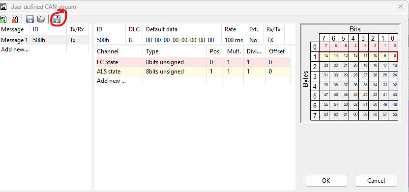

You need to create a user-defined CAN message in your ECU that includes ALS/LC status and then read that message in the ADU.

The section marked in red is the export CANx.
Simply load this CANx file into the ADU, and that is all — it is not very complicated.
Hi, thanks for your help but this still doesn’t work how I want it to. The ALS works ok but the LC doesn’t indicate armed unless I actually rev the car and enter the LC strategy.
