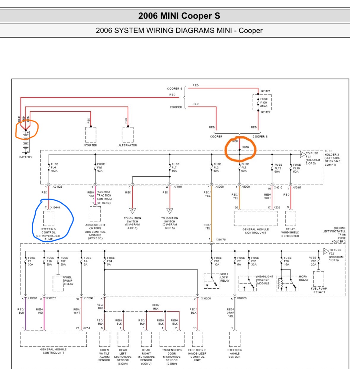

I measured a 0.64v drop from the battery to the main fuse box power wire. I circled what two points I measured in this photo. I’ve been talking to a few mini cooper experts and they think the hydraulic power steering pump (circled blue) is pulling a ton of current causing the voltage drop. When not running a stock ECU the pump operates in a fault state and runs at 100% all the time. If that really is the issue I’d like to figure out a way to control the pump speed with the ECU.

0.64V for what should be a large run with nothing but a fuse in the way is a bit odd, and probably where most of the 0.9V drop is occurring then.
are you able to measure both sides of the fuse?

Mini R53 epas doesnt use CAN to communicate. It uses K-Line so it is not possible to diagnostic and control it with the EMU ECU.
However in practice it works ok. The voltage drop is quite significant as the EPAS consume lots of current, but there are many R50 and R53 on Black and there are no issues.
