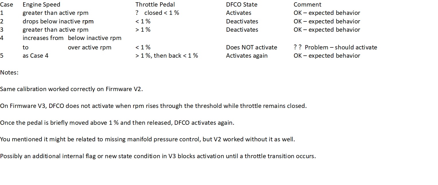

Overrun fuelcut doesn`t work correctly. When, for example, i drive with 3000rpm downhill and take the foot off the PPS it works as it should. If I now operate the engine in idle with the clutch disengaged, and then engage the clutch while driving downhill, the engine revs up to 3000 rpm but the overrun cut-off does not activate. Please have again a look at the logging and the mapping.

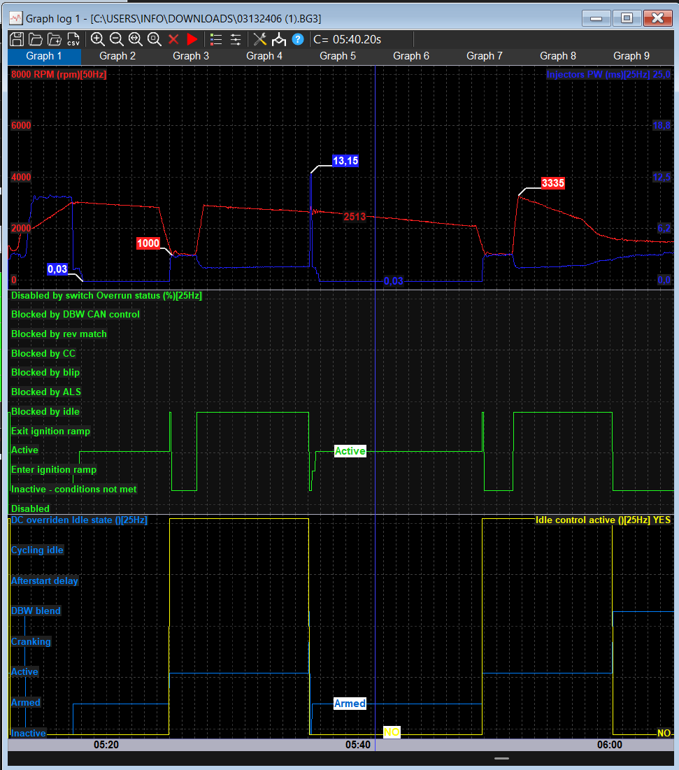

Could you tell at what time on the log shoul I look ?
At 5:35.00s i tab the pedal
At 5:35 the overrung strategy is activated as soon you left the idle state
Yes but at 5:17.0 it entered fuelcut as it should. At 5:24.00 i press clutch and engine drop to 1000rpm. At 5:27.0 i release clutch and the fuel cut did not engaged.
You were still at idle control and it blocked the overrun
Yes i see that but i did not know why?
Hi, i wanted to check if you can also see in the logging that the overrun fuelcut does not activate as expected under certain conditions. I´d appreciate it if you could have another look and let me know your thoughts.
It is in Idle because all condition are met to control idle RPM.
You do not use MAP sensor. In this case you can set the minimum pressure to activate idle so during engine braking, the idle strategy is inactive.
I understand that the MAP condition solves this for Speed Density engines.
However, what about DBW / Alpha-N applications where MAP is not usable?
Could a similar condition be added for engines without a valid MAP signal? Otherwise, the idle controller keeps blocking overrun after a normal downshift, even though the engine is clearly back in engine braking.
Is there already a way to achieve this in the current V3 firmware, or is this still not implemented?
