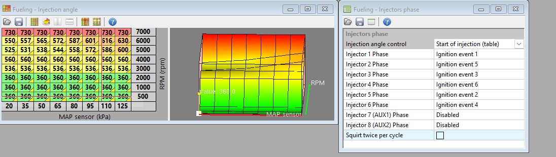

Injection angle
Hey guys,
can someone explane me how i can find the perfect Injection angle
Car: BMW E36 M50Turbo
Mods: rods and pistons
catcams 1301106
stock intake
Fuel: E85

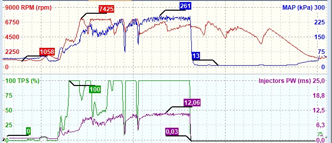

here i have a log from the last drag race
For port injection engines, changing the injection angle during high load high injector DC percentages really isn’t going to do much for you. You can mess with it under cruising or low load situations to which you would mostly be aiming for better fuel economy. Also you can achieve a better idle as well.
