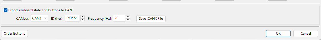

When you export a keypad CANX and import it, the address seems to default to 662. The selected export address does not follow to the CANX file. Seems to do the same with the CAN Channel.
Adding to this. Found that if you change setting, hit okay closing the keypad window, reopen, then export. Then the CANX comes out correct.
Thank you for reporting this. It will be fixed in the next releases of PMU and ADU. Until then, please keep using the workaround you found
