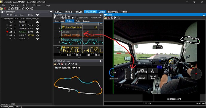

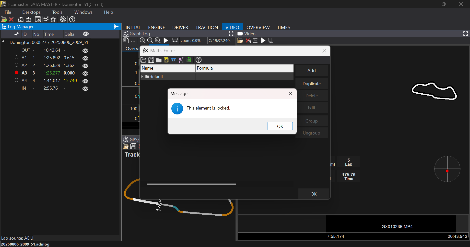

As for the @brakebrake track overlay, in my opinion the manual is not clear in this area. Maybe I’m missing something but how do I get to the alias editor window as shown in the manual? I’ve added a channel to the @brake graph log (see screenshot) this works fine in the graph but still won’t display on the track overlay?
