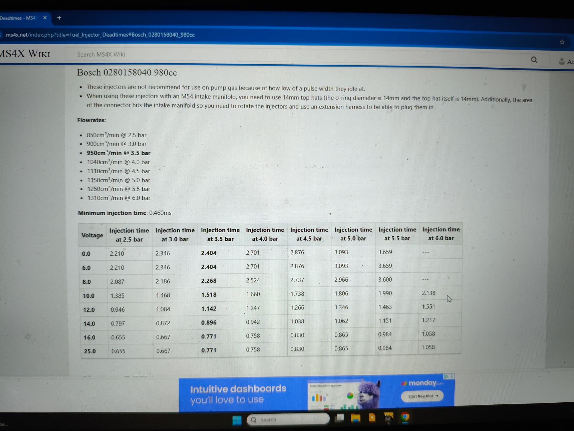

Btw dead times from injectors are not correct
Bosch 900cc

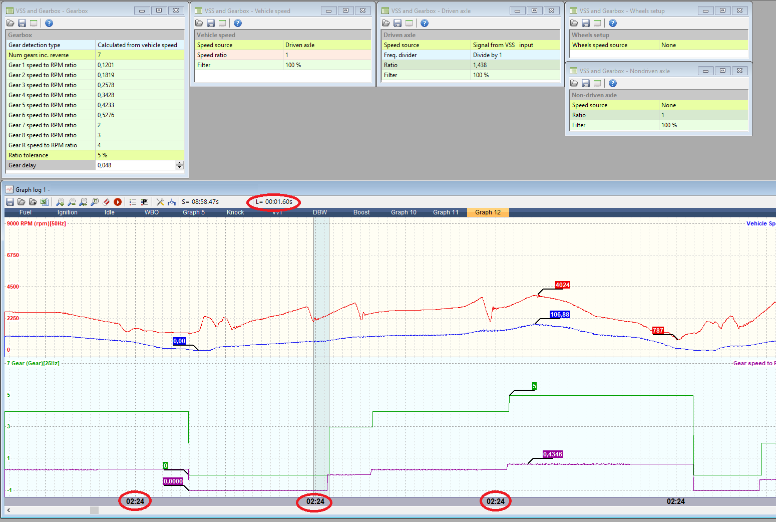

It seems to me that the gear calculation from the engine speed and the vehicle speed works slow especially if the speed is not high.
I checked in the log from a month ago where the firmware was 3.048 and the calculation after a gear change takes about 0.5s
Yesterday after upgrading to firmware 3.051 I noticed that the gear display after a gear change works slower. I checked in the log and the calculations after a gear change take about 1-3s depending on how fast you drive
And in addition, yesterday the system time display in the log was working correctly but today something is wrong
20250618_0858_gear_calc_3.051.emublog3 (1.3 MB)
20250618_0910_gear_calc_3.048.emublog3 (920.8 KB)
delay is caused by clutch pedal when pressed gear wont change.

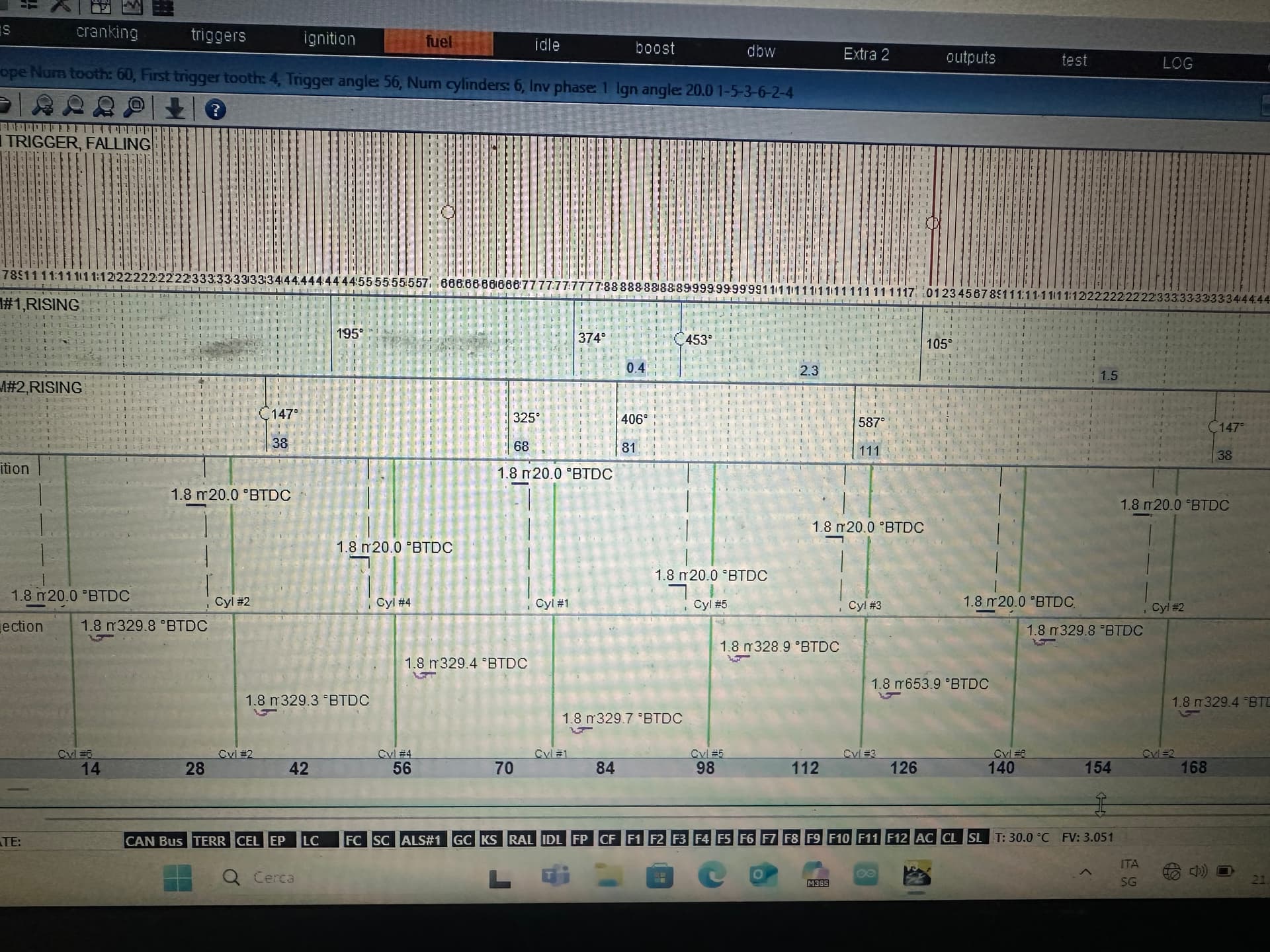

I had never seen this before, could it be the cause of the misfire that I have never found?
Cylinder 6 653 degree and other 328

Thanks for injector data.

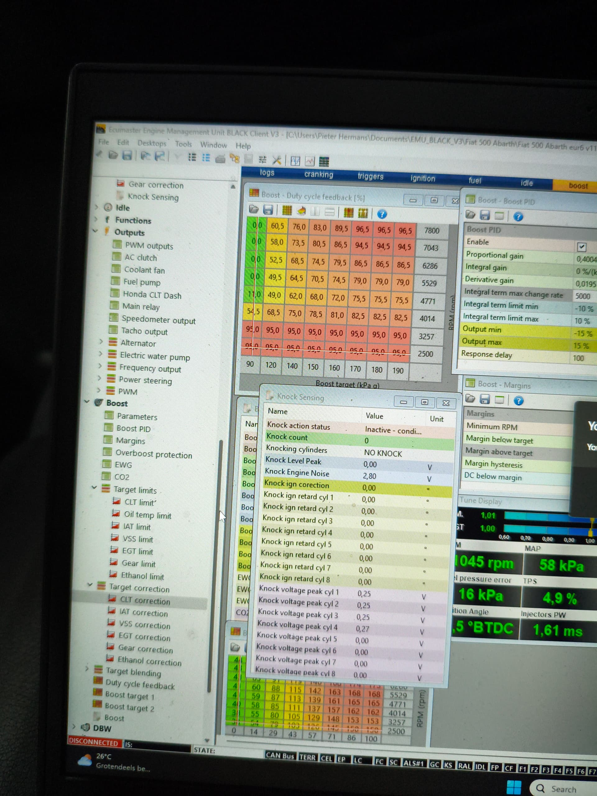

It seems to VE #2 table does not import the correct range and rise up to 9500 rpm
I did the test 3.051 and 3.043
the engine works better with 3.043, I have just rpm at idle, but the problem I think is the map reading… I tried with mercury test 50/100/150/200 kpa, but when the engine is running it does not have the right reading
You ahve probably set somethibg in configuration that makes the problem with 3.051.
Could you post your both maps and log files from idle for both versions ?

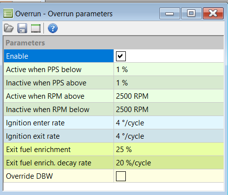

Hi, there is a problem with overrun,
it comes active or stays active when not wanted
20250626_0958 overrun.emublog3 (2.6 MB)
frimware 50 and 51
Set different values for Activate when PPS below and Inactive when PPS above. There must be hysteresis. Out there 0,5% or so. The same for RPM there must be hysteresis.
