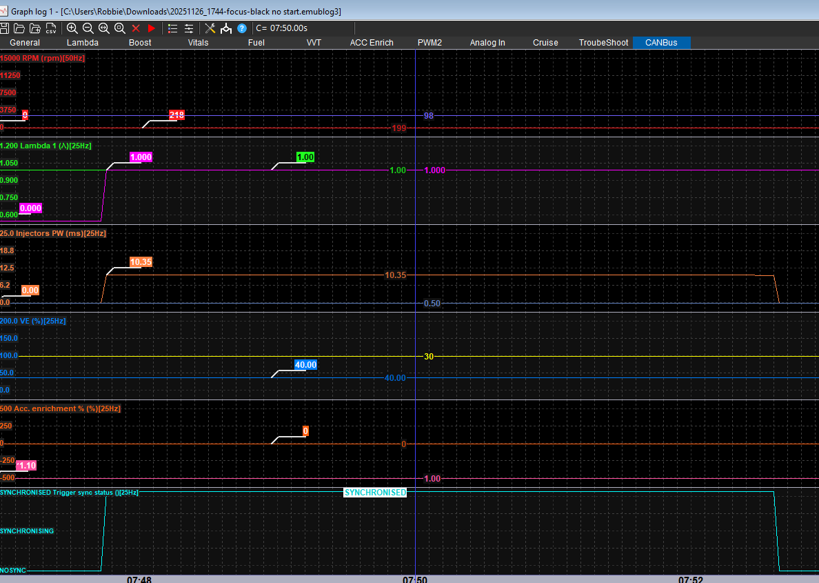

Working on a 2002 Focus SVT, this is the second car being build, so the claibration came from a previously running car. When we try to start the car the injectors are not firing. If we test the injectors we can have fuel delivery. From the datalog no fuel cut flags are being shown. Any idea of what can be? We try enable and disable the fuel cut delivery for ignition lock as well with no luck. attached datalog and calibration. FYI also TDC is being verified

However, after another look at your log it does show there is injector PW while cranking, 10.35ms. However your battery does seem a bit low while cranking too, so a jump box or boost may help it crank over faster while you are troubleshooting.
Your VE Table and Cranking fuel table hasn’t been modified. It appears the injectors are firing, but perhaps someone else can weigh in.
Send scope from cranking please. There are two strategies that can require brake switch during start: DSG and Cruise control - for safety reason.
Injector outputs are not assigned

Bingo. We accidnetaly owerwrite the ecu during connection and that deleted the injectors assignemnt. Thanks @kimbaku
