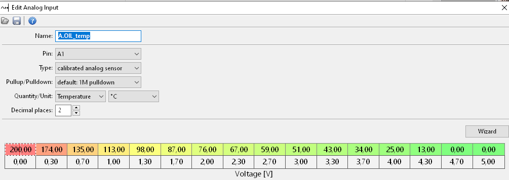

I entered the following numbers to ADU:
I have checked the calibration of this sensor, and indeed – at high temperatures the readings are about 10 °C off.
I have created a new calibration, and we will update the predefined sensor in the wizard.
Until then, you can add this sensor manually as shown in the screenshot below:
thanks, I will try it.
looks like it was 15C off around 152C. looks more reasonable now
