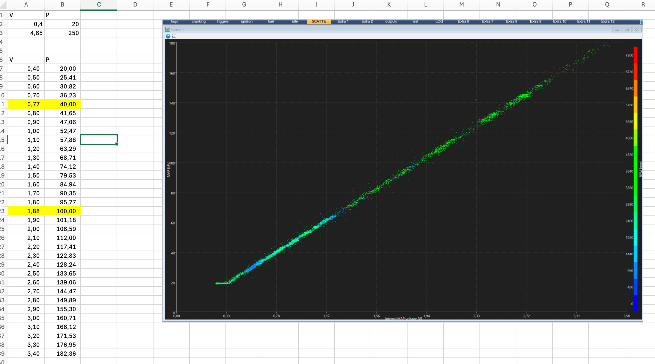

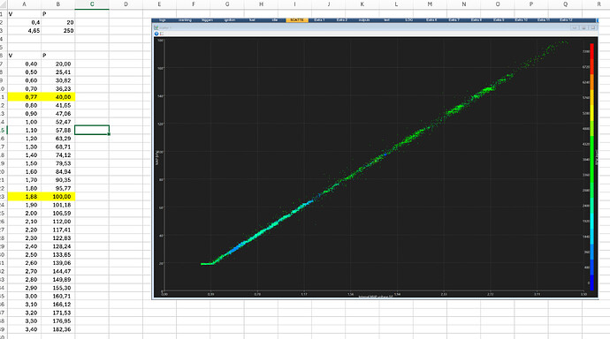

I have found a way to log the MAP in V3.
The scatter plot seems to correspond to the characteristics of the sensor.
However, the MAP is much too high.

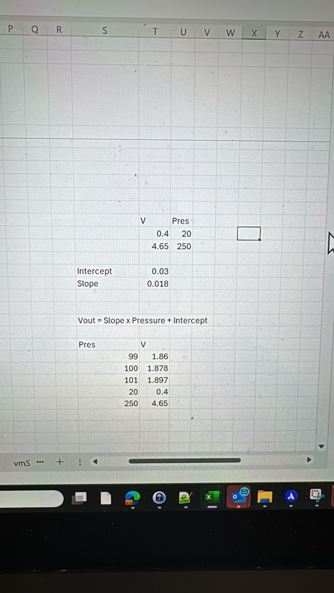

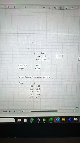

The equivalence between tension and pressure works perfectly.
I think the problem lies more with the voltage reading.
it seems that the voltage reading does not correspond to the actual voltage.

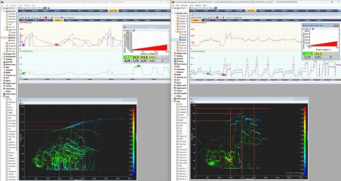

the maximum compressor pressure is 10 psi, i.e. a maximum of 170 kpa.
The MAP should never read a pressure of 180 kpa.

I looked to your configuration and it seems good.
Also the MAP calculations looks good.
It is virtually impossible that the analog input is read wrong as it is read as the other ones.
I’m actually on vacation and I’m not able to run it on the simulator.
But you can make simple check with the multimeter and measer the real voltage when the eninge is turned off. It should show baro pressure and the voltage should be the same as EMU shows.
You MAP can show more pressure in the situation when your exhoust is restricted (eg. melted CAT).

I’ve revert do V2.175 and everything is fine. MAP goes as expected.
I will check tension.
