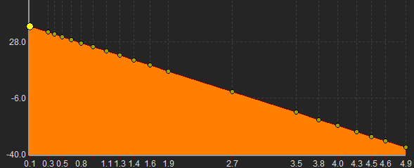

what I found:
Your Intake Air temperature sensor calibration is not representing a “normal” ntc curve.
You can create a calibration pretty easy by using the wizard.
The calibration is pretty odd which will negatively affect the fueling
Also your VE table looks pretty off by checking the VE tuner and logs.
You are running about -27% LTFT in idle.
I would suggest to disable the fuel film feature, tune the entire VE table and then tune the fuel film.
Also try to apply better values to your idle airflow base table from logged values.
Use the emu pro manuals for VE tuning and Fuel film for that.
