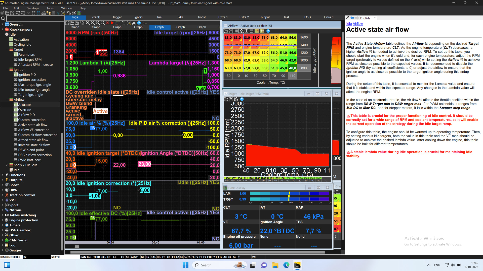

The RPM dip looks to be related to the lack of Airflow not fuel curently. If you will check your log just after startup when the RPM jumped to 1500 once the Idle go Active the RPM started to fall.
  1. I would increase the target rpm from -40 to 10 degrees to be like 1500 and from 10 interpolate to your desired target RPM at 70 CLT degree.
    BTW, 1000rpm for the Idle is a bit higher than a D16 would like to run, do you have agressive cams? or very big injectors that would require higher idle?
  2. Increase the Idle >> Active State Airflow so that Idle RPM reach the Idle Target. You can see that your Idle RPM can’t reach the target in the log for the cold part of the warmup.
BTW try the “Wasted Spark only during cranking” option, in wasted spark the engine will start faster at any coolant temp since it doesn wait for the sync. But do it later after you figure out the Idle airflow, one change at a time to not lot loose track of what affected the behavior.
