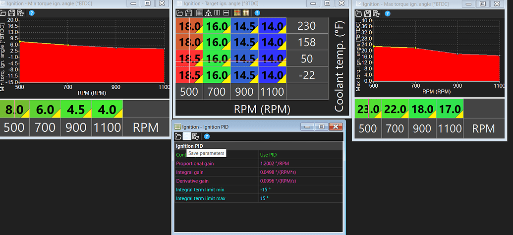

Having issue just cant figure out . When I press in clutch the car sometimes stalls at idle . When I blip throttle and press in its worse DECEL . I have tried overrun enable disable not change . No fuel cut .Made changes to the ignition target Min Max and target witch did help a bit . Tried to pid changes from .P0264 i 0117 d 0 to p1.2 i .0498 d .5 with no minimal change . Confirmed no vac leak . The drop is from idle target 1050 to 650 ish RPM where it almost stalls .ON A GOOD NOTE .Through this process have learned that idle control is great on this software . Anyone with advice is deeply appreciated . Thank you See attached log.

Dont forget to set stop screw on TP to met ignition advance target value…if you dont use iac valve you have to run more tp opening and less ignition advance to get idle strategy any playground

Im Thinking your configuration is correct but I may need to increase the pid to react quicker to the drop . Any thoughts ? THANKS
I think the PID is enought quick…but maybe 15° of max advance is not enought to cath that idle…try a little more throttle opening…to run just 0-3° on idle how its behave or send your current tune and i try adjust the limits
