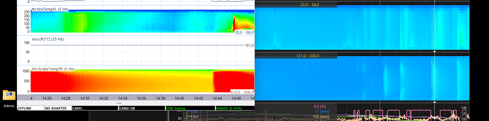

Tire Temp in Data Master
we work with Daniel Stratmann,
he recognizes that the Brake Temperatures not showen right.
in DM its shown 4-5 Times lower.
And in ADU Graph Log its visually better presented, also Tire Temp.
Best Regards
