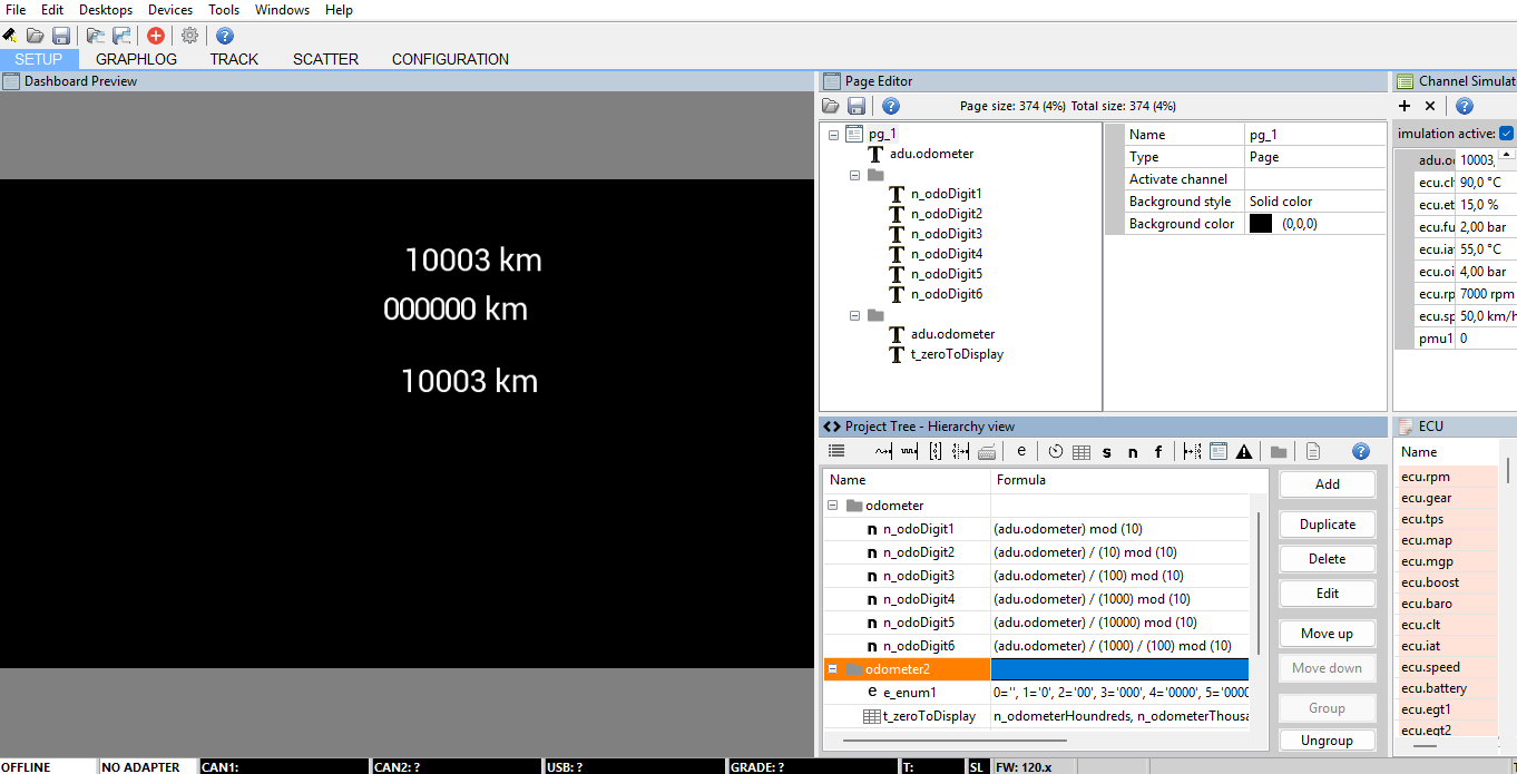

this is the setup screen for when i try to set up the table.
Yes, there is a problem with this table. Generally, adu.odometer is a 32-bit channel with 3 decimal places. The maximum value for channels accepted by the table is 16-bit, so effectively in the adu.odometer case the maximum value is something about 65 kilometers.
Generally, there is something that needs to be changed so that you get feedback from the UI that you can’t set a number higher than possible. Currently, there is no such feedback, which can be confusing.
However, what you want to achieve can be done with the current implementation. In the attachment you have 2 examples with 2 different ways; both give the same results.

thank you! bot that file is still not working for me.
Yep, to get this to work, you need a connected ADU. All calculations are performed on the ADU device, not on the client side.
clear, thank you! will try it next week.
