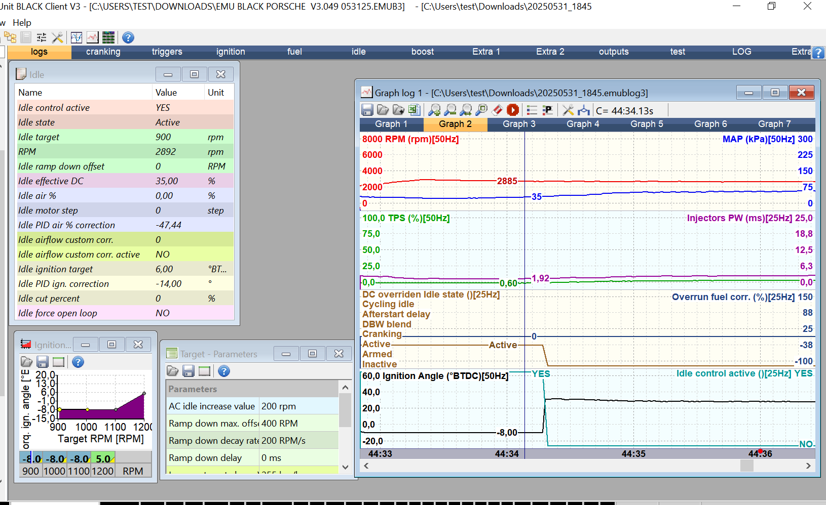

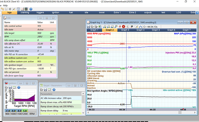

I have been chasing a backfire situation and can’t pinpoint it. In the image, the backfire happens after downshifting, letting the clutch out, the rpm starts to climb, and I begin to ease back in to the throttle (backfire happens at TPS = 1% in the log.
I noticed that the engine leaves Fuel Cut and goes in to idle. The closed timing timing control comes in and the timing drops to -8 deg, BUT when I let out the clutch in second gear (from third), the RPM starts to climb, but the timing remains at -8 and drops from 1200ish to 900-ish on the two timing correction charts. The actual timing follows suit. Am I doing something wrong here or is this a bug?
Back to the backfire, I am stumped. I simply don’t know what to do to eliminate this backfire. It doesn’t happen all the time, but it does happen often when down shifting, a short bit of engine brake, and then getting back in to the throttle…BOOM! Help!!! Please!!!
It looks weird, your idle control is active altough its clearly above ramp down max offset rpm, also your minimum torque ign is not being applied correctly, i think maybe its a bug :thinking:
