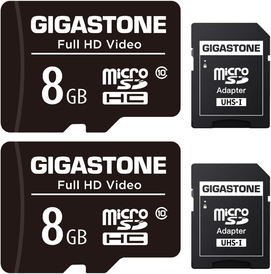

Hey guys… so, the issue was actually with the memory card…
I tested this card (see link) and installed the latest firmware — and what do you know… it works!
In the newly released EDL-1 manual, we have added a list of supported SD cards https://www.ecumaster.com/files/EDL/EDL1_Manual.pdf
