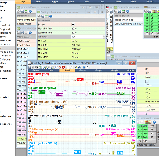

Hello, started a couple of weeks ago with 2.175 and an older FW, that still had EGO correction available. The correction did work , but there had been issues with Autotune, as the corresponding table layout did reflect a MAP bar column, but the set up is utilizing TPS. So, I updated FW and made myself familiar with the Short Term Trim, which is similar. Now, I did realize, that the log graph stays at 100%.
My question: is there some pre-condition, that need to be fulfilled so that the sheet term trim does work as expected?

…and here are attached my project and recent log file…
The project is far from ready.
Configuration: 2L Ford Zetec Blacktop, OMEX ITB , equipped with fairly big injectors(440ccm), 4 in 1 exhaust.
The car initially was equipped with a different ECU, found then a company who was familiar with EMU Black and was quite OK initially. Then, two O2 sensor´s died…the mounting position was wrong and the sensor did show down to have the wiring nicely go below the car. The overall tune was also fairly rich. Then decided to get into some depth with the EMU black and started with tutorials from EVANS Performance , which did help launch some deeper knowledge. But I would call myself still bloody beginner…as a few other items yet to be solved. Currently, poor or no idle and the short term trim does not show any feedback within the logs…
Thanks for any feedback.
Udo
Ultra_TT_20250902_0851.emublog (219.3 KB)
status_02SEP20025.emub (146.2 KB)
It’s because of your MAP value, its loged as 100 always and your short term trim settings allow it to work between min 20 kpa and max 70 kpa
Is the manifold hose connected to the MAP sensor port on the ECU ??
..well, because of the ITB, I am on Alpha-N strategy…I did assume, any settings towards MAP would become obsolete with that…
…still I can verify after lunch…
