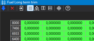

To show the Long term trim table, you need to add a new panel (by right clicking on existing panel or just F9 key), search for “long term” and choose the “Fuel Long term trim”. These data are stored in ECU only, so you need to be connected to the EMU PRO.
First button with a blue arrow will download the table data from ECU. The red cross will clear it, the third button with a white arrow will transfer all long term trim corrections to the VE table.
