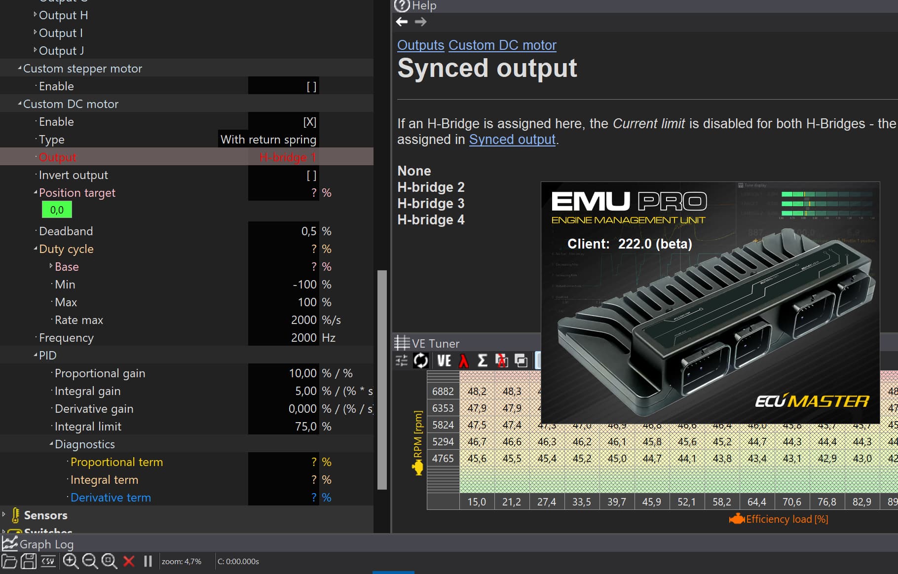

@mkuklis_ECUMASTER btw is there any defect for the Custom DC motor menu, I don’t see the option to select sync output in version 222.0
