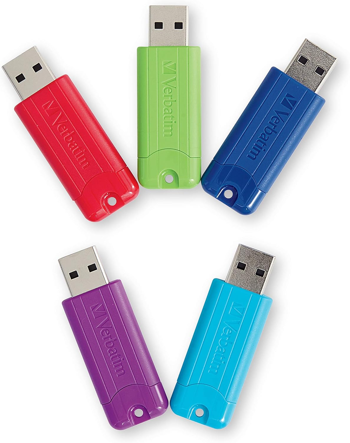

I ordered a set of inexpensive Verbatim 16GB drives and they worked great, we were able to record the full 85,347kb, which turned into 9 files for a 7 hour race. With the 9th file being the last lap of the race and the first file being warm up and sitting on grid. So each file held about 26 laps/1hour of racing.
Thank you for the feedback, it is great that you solved the issue.
We have bought the same pendrive model as your problematic one (at least it looks the same, but it is from European distribution), and we did not observe any issues with it.
Perhaps this problem was related specifically to your pendrive unit.
