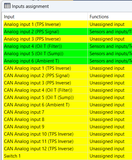

Possible UI bug with the user defined names on assigned inputs screen? Not sure if this has already been reported :+1:
Thank you! added to the bugtracker
