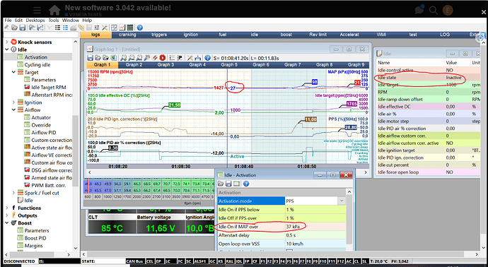

Idle state is active altought its clearly below map threshhold. Am I missing something? . Using dbw
I think you are missing. “Idle on if MAP over 37kPa” and your actual MAP reading was 27kPa.
Problem ist already fixed, it was a bug- My settings were correct :+1:t5:
