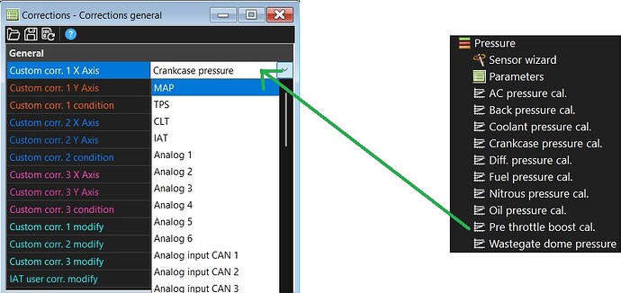

Could you add in the “Fueling - Corrections - General” the option to select the “Pre Throttle boost sensor”.

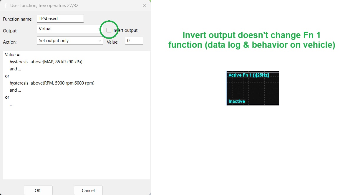

Sorry for the double post, as a new member I’m not allowed to attach two images.
Could you also have a look at the “Functions” “Invert output” option. It doesn’t seem to change the state of the Fn1 function (I didn’t check Fn2, 3, …. etc).

Make sure you close the function setup window.

Thanks for the help. Unfortunately closing the function setup window didn’t solve the issue in my case.
Screenshot of test with fn 4 and a simple function (function was closed during experiment). Second bump is with “inverse output” enabled, but fn 4 logging channel response remains identical:
OK on V2 if I remember, invert was only valid for hardware output, as you can see says “invert output” so probably if you had assigned output that would invert it… not sure if is working on virtual..
