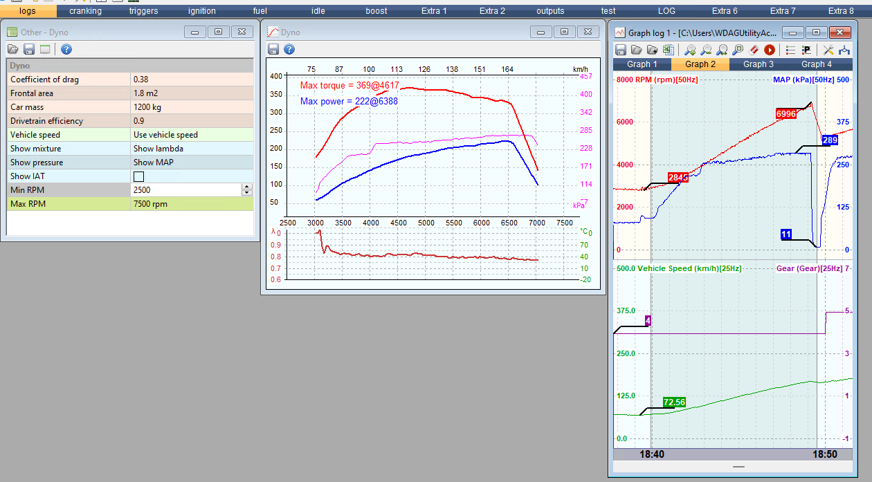

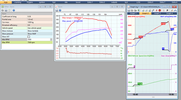

Hi there, I just installed the new software, put the correct numbers into the dyno settings and loaded a log. The chart however is not really what it should be. The car made 480 engine HP / 530 engine NM on this boost pressure on the dyno before.
Something I should pay attention to?

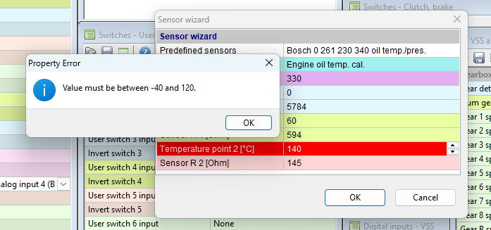

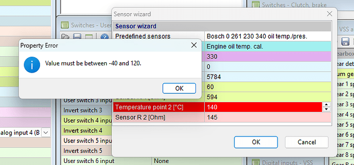

Why this limitations please? If i want to calibrate VAG 03N906081D oil tem sensor which is measures up to +230°C i can not do it wia wizard :frowning:
