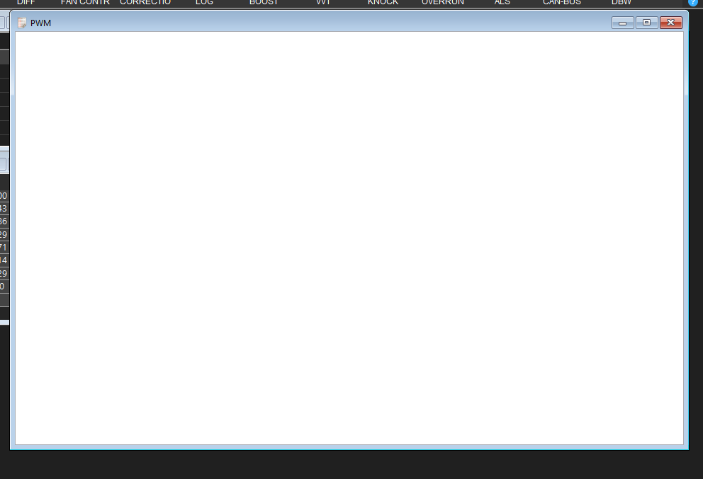

This window remain blank

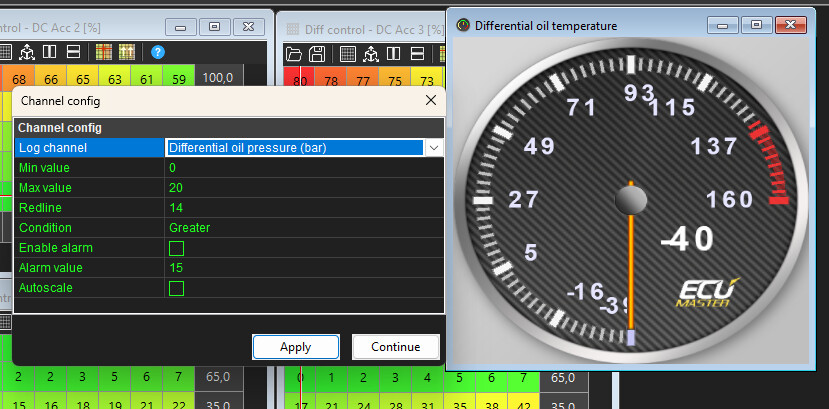

Also i want to change gauge data to see diff press but it doesnt work

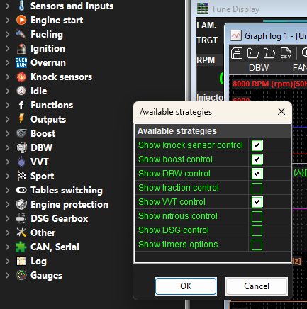

If i turn off DSG controll it should not disappear from menu?
