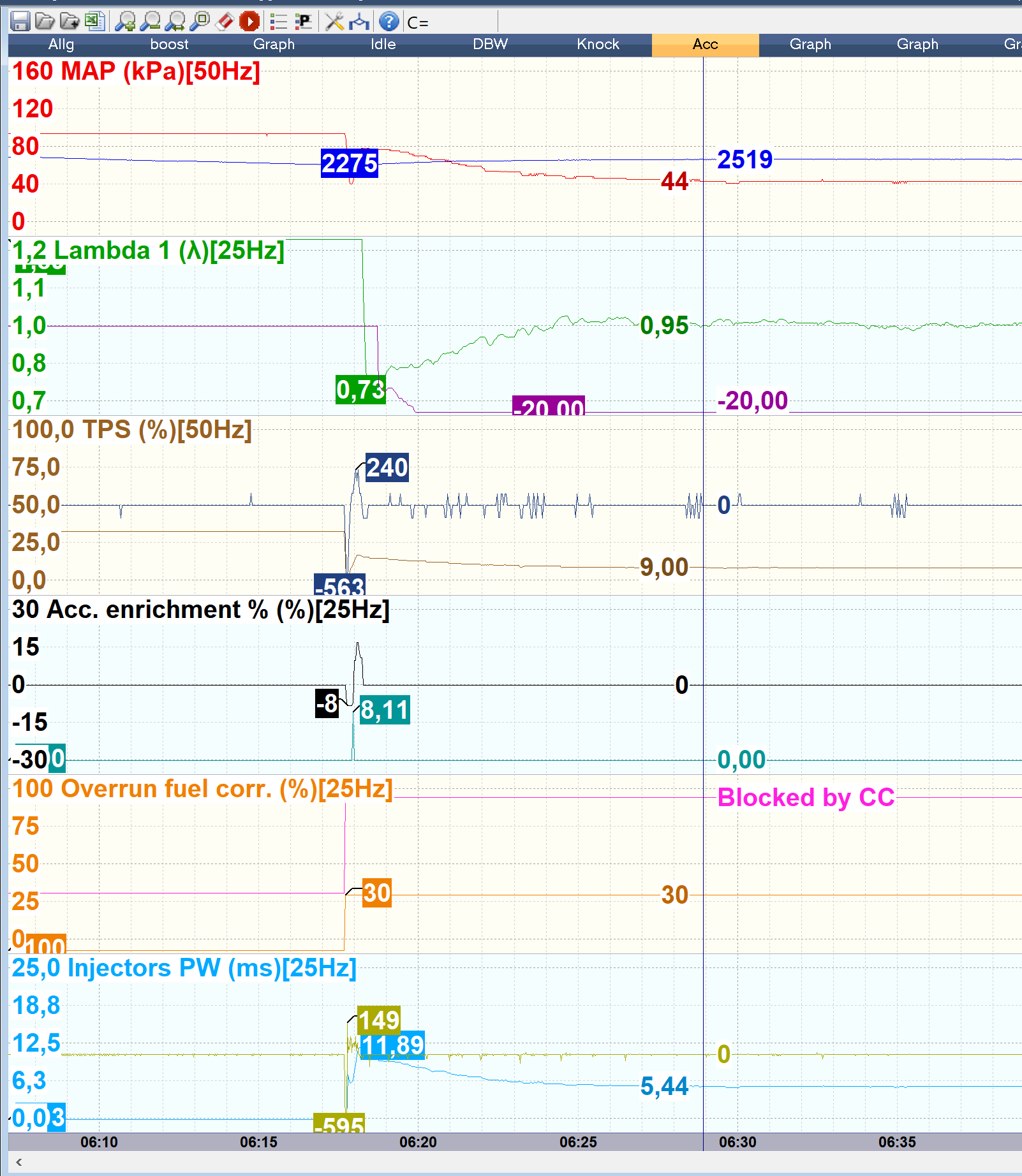

i am useing SW 3.029 atm and played a bit with DBW CAN control and cruiscontrol and both seem to have strange interactions with overrun:
I send 70% DBW via CAN, which is executed, but if i release the pedal, the overrunstrategy gets active and cuts the fuel:
Similar things happen when i use cruiscontrol. It is working here, but somehow overrun strat is adding 30% enrichment from exit strat:
It says it is blocked by CC…but the short term trim runs into its maximum of -20%, which means it is not blocked.
Here some logs + mapping:

I here have a log, where the overrun CC issue is good visible in the end.
20240708_1937_rev56_CC.emublog3 (572.5 KB)
AudiTT_AJQ_rev56_accrich.emub3 (61.3 KB)
I first activate CC while overrun is not active → CC behaving as intended
Then i activate CC via resume while overrun is active → CC gets active, but overrun adds 30% fuel permanently.

I see following bugs:
  • if CC is activated during overrun…fuel enrichment from overrun exit stays active
  • Throttle target table not working
  • new plus and minus function not working
  • If CC is active and vehicle speed exceeds targetspeed, throttle target is set to 0
I upload some more logs this evening.
The table and strategy worked before as we tested internally (except the overrun). However maybe something broke. We will test it and fix asap.
