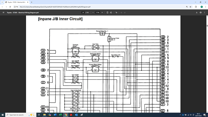

I’m wanting to install a PMU16 to replace the Fuse panel. This fuse panel has 2x noise filters installed. Could someone advise if these would need to be retained or once the circuits are separated onto individual channels of the pmu16?
On a side note, some of these circuits provide interior lighting around the car. is it possible for the PMU16 to dim the lighting as it’s turning off?, possibly through PWM? Instead of going from 100% to 0% instantly.
No need for noise filters with PMU.
Those noise filters are for voltage spikes from the relays switching.
You could use PWM, but it’s available only on the 25 A outputs.
