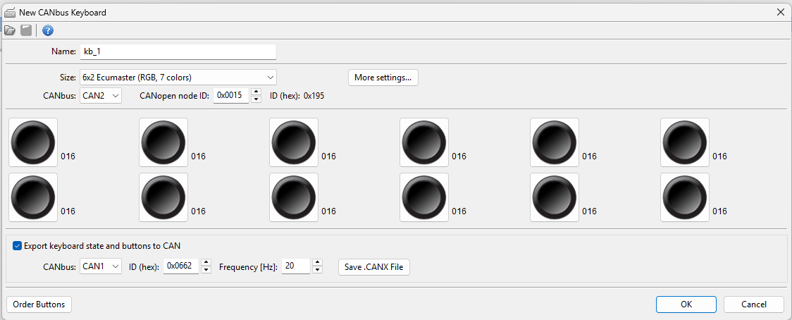

Did you setup the export ID in the Keypad setup on the PMU and make sure its on the correct bus?
Bottom of keypad setup for export.
