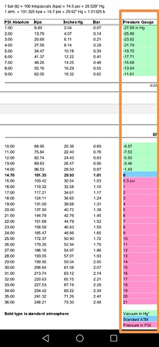

Can you please add more flexibility for the units psi usa pressures in psi, not psi a or psi g in boost maps its confusing.
In map its psi a in fuel pressure sensors its in usa psi but written psi a.
