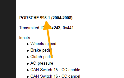

Porsche definition in the help file should be 997.1, forgot to mention it a few versions ago. The dropdown to select the vehicle is correct.

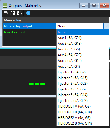

@Jadzwin_ECUMASTER sending the state of Main Relay via CAN bus is not added?
Log channel: Main relay state

yes, thanks.
I thought there would be a CAN bus in the drop-down list.
Will be added in next build.
